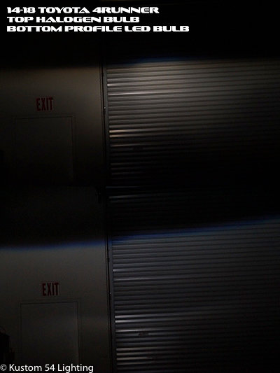

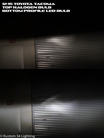

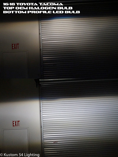

    Took some time and did a comparison of some LED bulbs we are about to carry. The pictures were taken with the same setting and at a 25FT distance. Some headlights turned out to be a bust and some were surprising.
    2014-2014 Toyota 4runner
    These headlights just have the most horrible projectors we have ever seen. Honestly, can't believe Toyota let those lights leave the factory.
    2016-2018 Toyota Tacoma
    These lights have a halogen variant of an RX350 projector which turned out to have decent output with a little bulb upgrade.
    2012-2015 Toyota Tacoma
    This set as expected got a little upgrade but since its a reflector housing, it also got a little glare which looks almost like a cut off that you couldn't see with halogen bulbs.
