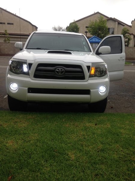

    On my 2nd gen I've done:
    DTRL/Front turns
    Parking lights
    Fog lights
    Reverse lights
    3rd brake light
    Map light
    Done lights
    License plate light
    Rear turn signals
    Doing the headlights this weekend
    Headlights now LED

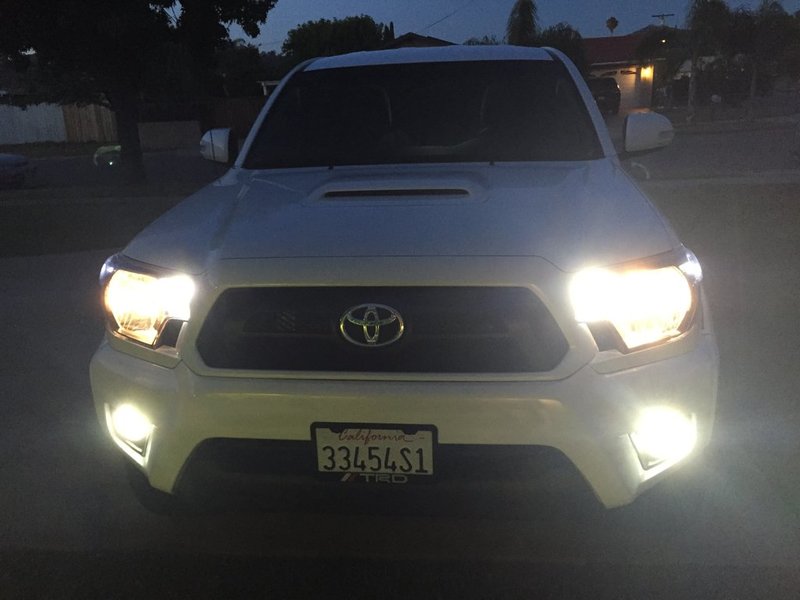

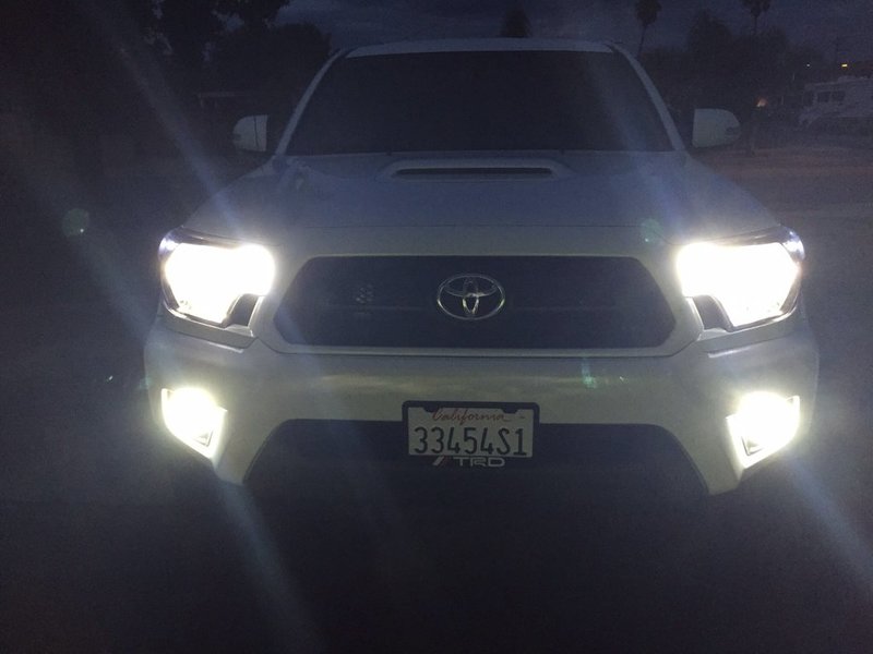

    Below is after the LED headlights were added

    I thought it was Illegal to switch you're DTRL/Front turning from amber, they look white in your pics.

    It is. But enforcement isn't always there.

    He might also have "switch back" lights. Which are white when running, then switch to amber when you activate the turn signals.

    Correct. They switch to amber when the turn signal is activated

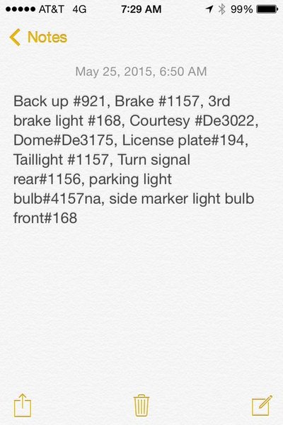

    Here is a list of the bulb #'s for a 01 - 04 Tacoma

    Thanks man! And I'm guessing that I just type the number in along with "Led" and the right one should pop up?

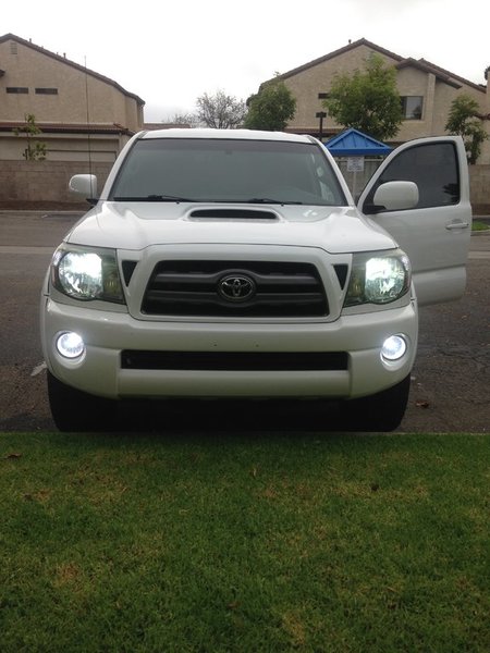

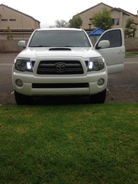

    Mine are from Jumpers LEDs, My headlights are HID. Also have the DTRLs white and turn amber when turning.
