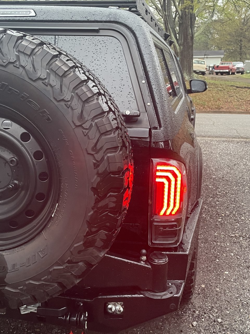

    Not sure how to fix your issue but if you want real LED rears Morimoto makes a quality set
