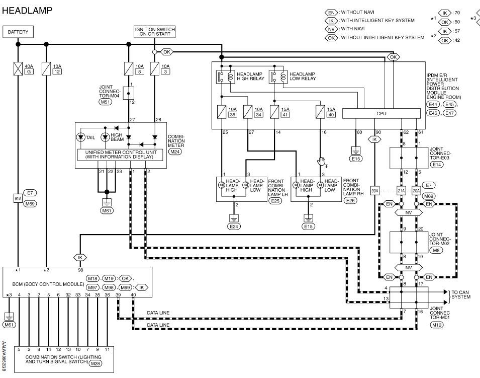

    CanBus is a big buzz word for simple 100 ohm resistor put in parallel with the bulb. It is just to take few times bigger current than LED itself could and it is to fool some European cars "burned bulb detection circuit" which otherwise would trigger computer message that particular bulb is burned. For most of USA and Japanese cars that feature (resistor) is just a waste - turning battery juice to heat. Whenever I get the "CanBus" featured bulb I get my soldering iron and remove the resistor which is quite often clearly visible.
    By the way this "CanBus" buzz word is used incorrectly by all sellers (most of them don't have a clue what they sell anyway). CanBus is a digital data buss between computerized modules used more and more in cars. 95 Tacoma does not use CanBus for anything else then linking ECU to ODBII port. My 2014 Nissan versa Note drives me nuts, where everything is computer controlled and connected with CanBus. AS an example: dash display (all bulbs, meters and gauges) are controlled only by its own Computer not connected in any way to any switches or sensors. That computer is connected via CanBus to other computers which tell the status of the whole car. For example blinkers for headlights there are three computers involved:
    Master Body ECU is connected to light switch then sends the data via CanBus to Combination Meter ECU which will light the appropriate indicator lamps on the dash. The same data is going to Inteligent Power Distribution Module (Power ECU) which will turn on power to headlight relays.
    Quite interesting is turn/hazard light system: Turn switch is connected to Master Body ECU which is controlling the power to bulbs, and also sends the data via CanBus to Combination Meter ECU. Combination meter turns power to turn indicator on the dash and sounds the "click" on the speaker, so you think you have a mechanical flasher (which you don't have).
    My 5th gen 4Runner is not much better. Shitload of computers talking to each other via CanBus.
    Sorry for the lengthy OOT post but I think is is cool to know what you can expect in turd or future gens if you ever decide to dump you pure mechanical 1st gen.
