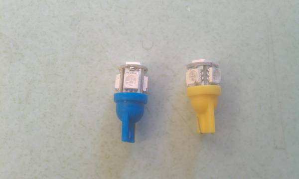

    When you get bulbs for doing the cluster, stay with the 5 LED bulbs at 360deg view. The ones that are 9 LEDs and up are too long to fit properly, and disperse the light evenly. Also, I recommend getting the 5050 LEDs which are brighter than many of the other ones. These are the ones I buy in bulk:
    Also remember that an LED has a voltage polarity. If you install it into the socket, and then install the socket into the cluster and it does not light up, simply remove the socket and install it 180 Deg off your first install.
