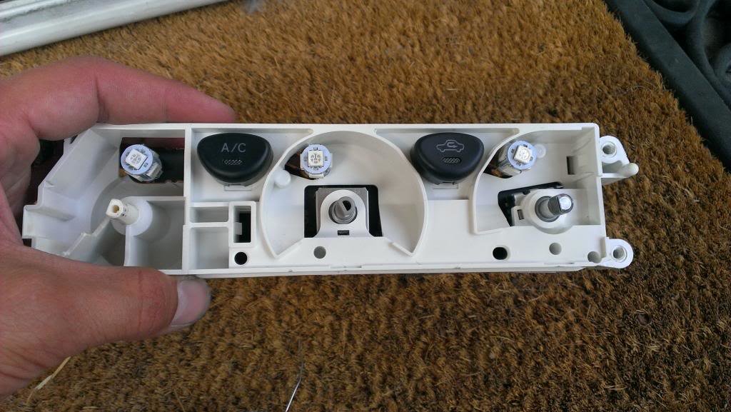

    All my LEDs will dim via the dimmer knob...
    Here's my black ops green theme:
    More detailed pics on my build HERE.

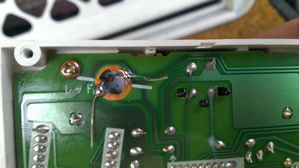

    Instead of pulling out the thermostat lights and installing the bulbs in the toyota holder I used 3 of the 360 t10s and just soldered them to the board. They're a lot brighter and the color is a lot more uniform.
    Took me all of 10 minutes after I broke one of the stupid 74 type leds which I had already used in my ignition light.
    The fit perfect and have a nice flat bottom to use. Just make sure to check polarity before soldering them.
    Both the speed and temp control knobs are the same orientation but the direction is reversed.
    Not my best soldering ever but it'll hold!
