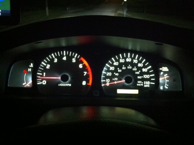

    My dash is slowly coming along. I wish I had ordered all my bulbs at once... smh... So far I have done the gauge clusters and the temp control face. I also want to find a way to make the clock red, or I may just get rid of it since I have a clock on my radio and use the plastic that goes in place to mount switches. and im going to do the shifter bulb either red or white. not sure yet. opinions?
    heres how it is now...
    only complaint is its a little spotty behind the temp controls, but its really not too bad, and at night its MUCH better. the blue on the middle knob doesn't let the light through very well either.
    I used:
    gauges - WLED-xHP5
    temp controls - NEOx-xHP (4mm) (thanks to Taco Man in HD for telling me the bulb type)
    and going to use 74-xHP3 for the shifter
