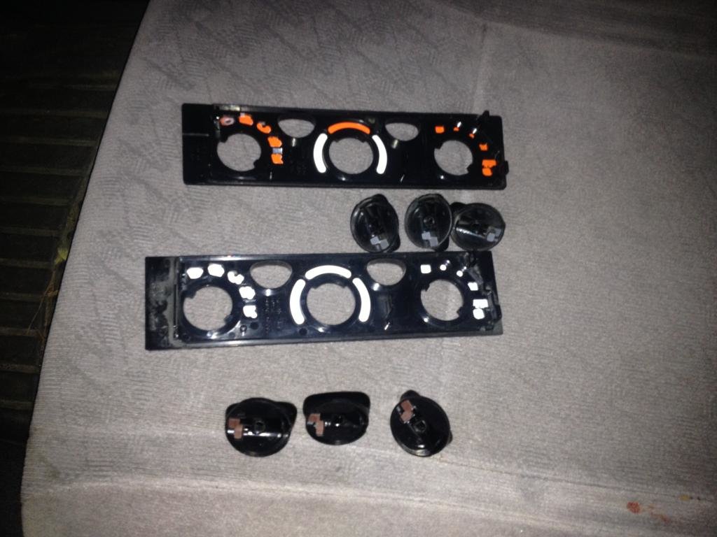

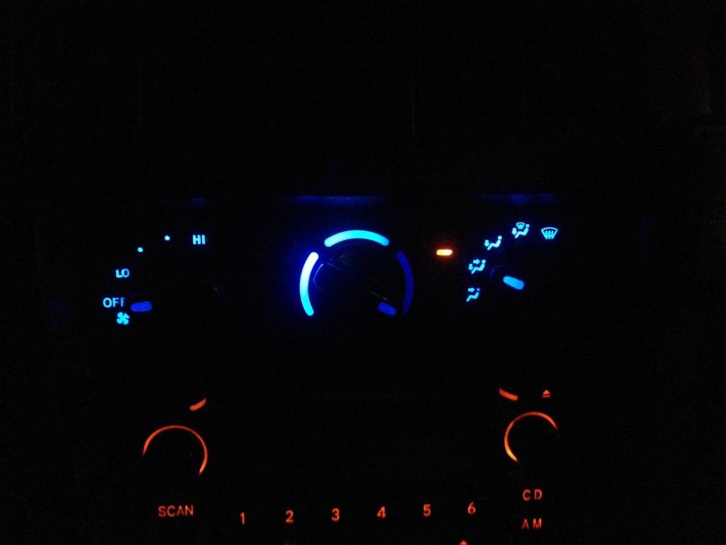

    Also finally found a solid solution to anyone who wants to run blue or green AC panel lights but do not want to use a new face plate (personally stock faceplate is clean and adding a white one mucks up the whole section)
    Turns out since 99-02 ( I believe) 4 runners used green lights they had clear white faceplates and knobs.
    Plates side by side:
    Old (Hardcore hot spots and not uniform color):
    New (Uniform color, no hot spots)

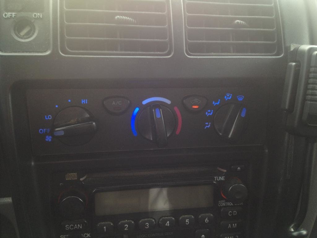

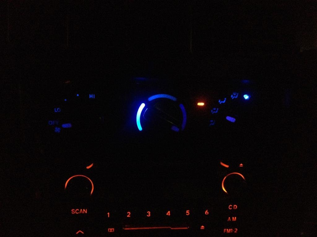

    Can even see the blue in the day now:
    Very happy with figuring out a solution to this.

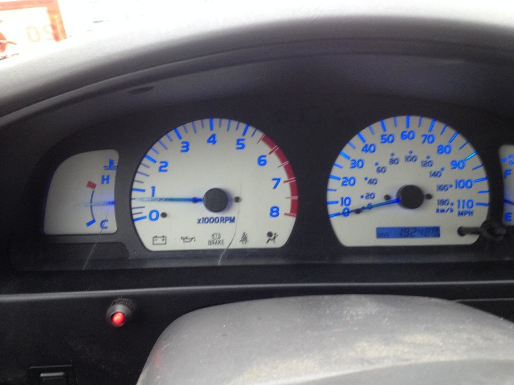

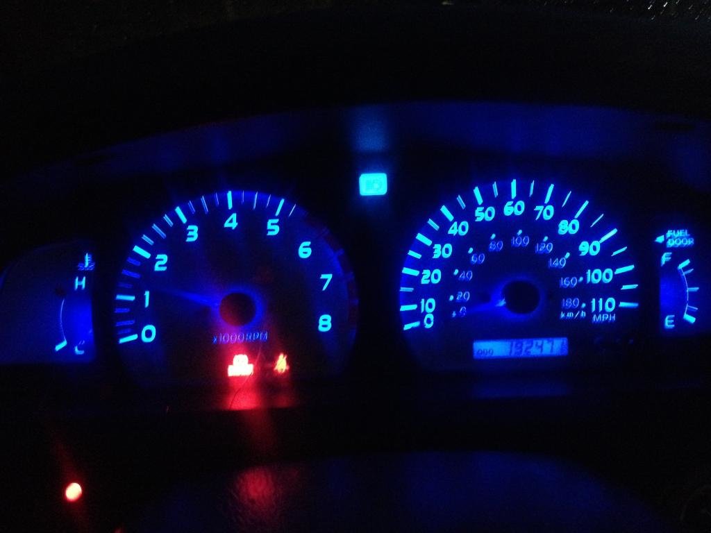

    Also pics of dash:
