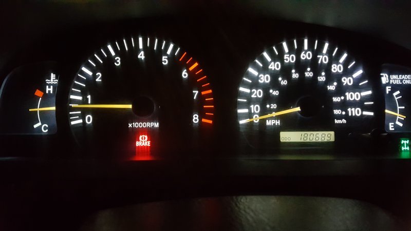

    Used the 5 led whites ,i love it not too bright at night perfect the old dtab green was bothering me

    Looks good!
    Where did you buy them? What type? Is that warm white or cool white?

    Yeah that's a good amount of brightness. Some other led bulbs seem to put off too much light for the dash. Which exact bulbs did you use? And why does temp gauge mark below half? I'm jelly.

    I like it. I did mine in white right after I got it.

    That seems a little too bright for my preferences. I prefer as dim as possible for night driving, otherwise it's like having a flashlight in your face while trying to see out the window. I have a pile of 194's I got a few months ago. First put them in the license plate lights, and their brightness scared me off from putting them in the dash.
    Just make sure you get dimable LEDs, so you can still use the dimmer dial on the dash.
    I'm considering going all blue, just for a little updated look, and softer light. But I might try the ones I have. If they're dimable, they could work, too.

    I can dim mine to a soft glow...

    That temperature gauge pointer is exactly where mine sits, and has been sitting, for 19 years. 'Cept when the engine is not warmed up, that is.

    Could you point out where to get these types of LED's? I know most LED's bleed light through the lens but these are perfect.

    Runs 10F cooler when the t-stat jiggle valve is installed at the 6 o clock position. (3.4l)

    I was being a bit cheeky. Messing around because of the huge dead spot on temp gauge. My 2.7 has thermostat correct at 12 o'clock. Needle in middle. I like those LED's though

    My thoughts were the same that they may be too bright but it is not it worked out perfect

    hmmm... I guess that could be possible. I swapped from another (tachless) cluster and the temp gauge always sat halfway on that one so I figured it was the cluster

    I flipped my T-stat from 12 (thanks dealer techs :rolleyes:) to 6 and the temp needle went down ever so slightly, same position in the earlier pic.
    Mine was with the 3.4 tho
