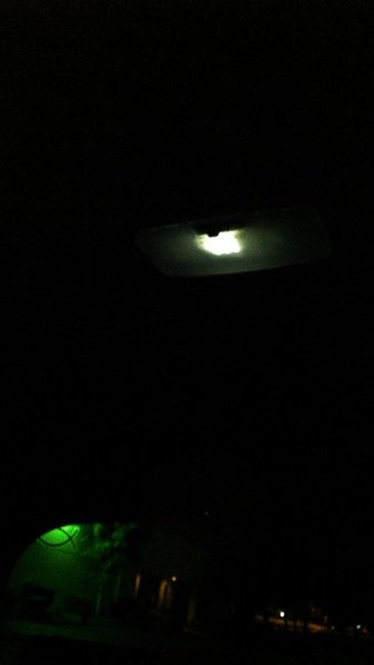

    Has anyone else experienced this problem? I put LED's in my dome and map lights. Problem I have is that when I have the dome light set to go on when the door opens, when I close the door the light stays on very dimly unless I manually switch it completely off. Not a timer issue, over 10 minutes and it was still on. Here are a couple pics I took with my phone - 1st with the light in "On" mode, next when it should be off:

    Sounds like you have a residual voltage difference in the circuit that you didn't notice with an incandescent bulb, but easily noticeable due to the low voltage required by the LEDs.
    I'd grab a multimeter and check to see what the constant voltage you have to it when the switch is in the different positions. You may have a bit of a faulty switch.

    Since the dome light is controlled by an electronic circuit, there will always be a tiny amount of voltage and current leaked by. Some multi-chip LED bulbs/modules are more sensitive to this than others due to the way they are constructed. A single LED can emit visible light with very little voltage (less than 3 volts) and very little current. You wouldn't notice this with an incandescent bulb because it requires far more current and voltage than LEDs.

    That's kind of what I was thinking. just sucks having to forego my dome light coming on when I open the door. Might bite the bullet and put the stock bulb back in, at least the map lights will still have the extra ooomph!
