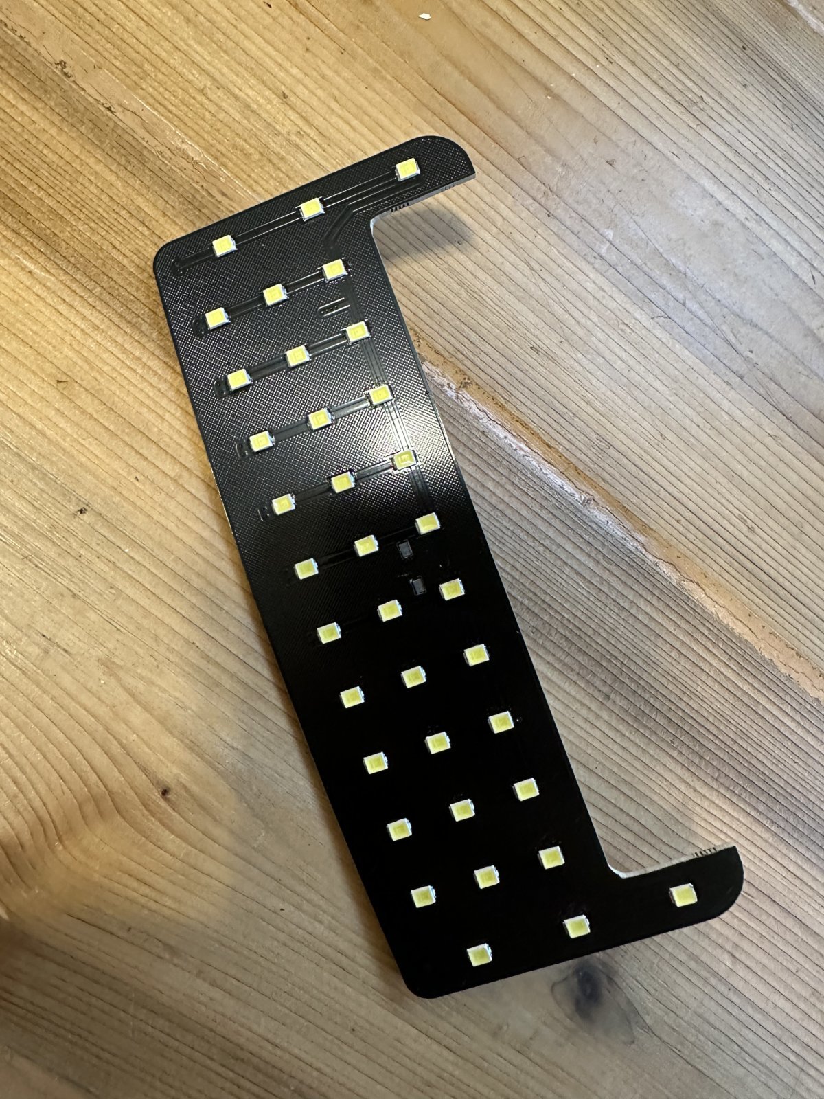

    I bought this led dome light board off of AliExpress for $16, looks pretty bright, but haven’t checked at night yet. I’ll take some pictures when it gets dark.
    Cheaper than most LED solutions out there.
    Fits rav4, Prius and corollas.
    Thought I would share.

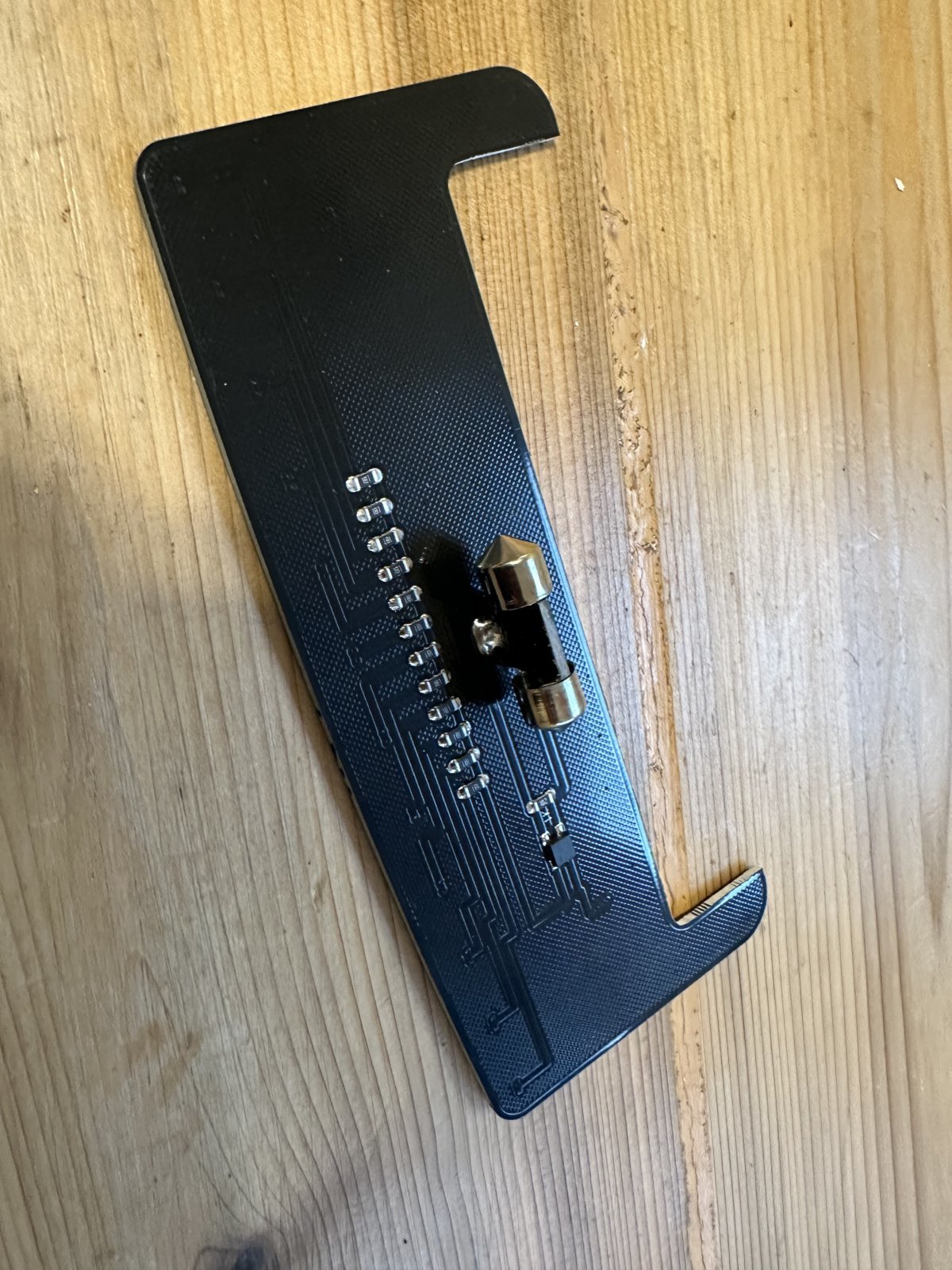

    looks like a well-etched pcb. main failure point is them designing the board for thermal dissipation, but then using current-limiting resistors for power 'regulation'. most design such boards for an expected 12v, meaning that operating the light while the truck is running is over-volting the led's... there's a dozen better ways to do it with a current limiting driver that better responds to led chips dropping forward voltage as they run up to their thermal limits.
    most common failure mode is the resistors not shunting spikes, the cheap led's being less tolerant of spikes, and depending on how hard the led's are driven, i've seen the resistor solder joints melted apart.

    Current limited is ideal given the inconsistency of supply voltage combined with voltage sensitivity of leds. As with many boards Meso’s just use resistors rather than true current control.
    Any of these boards can be adjusted by installing a driver in line or changing the resistance.
    I’ve had the Meso maps & dome for several years with no truck electrical problems but the products aren’t nearly as lasting as leds should be because of the lack of true current control and mounting on plain pcb’s instead of mcpcb’s (metal core printed circuit boards) which are used in high lumen applications.

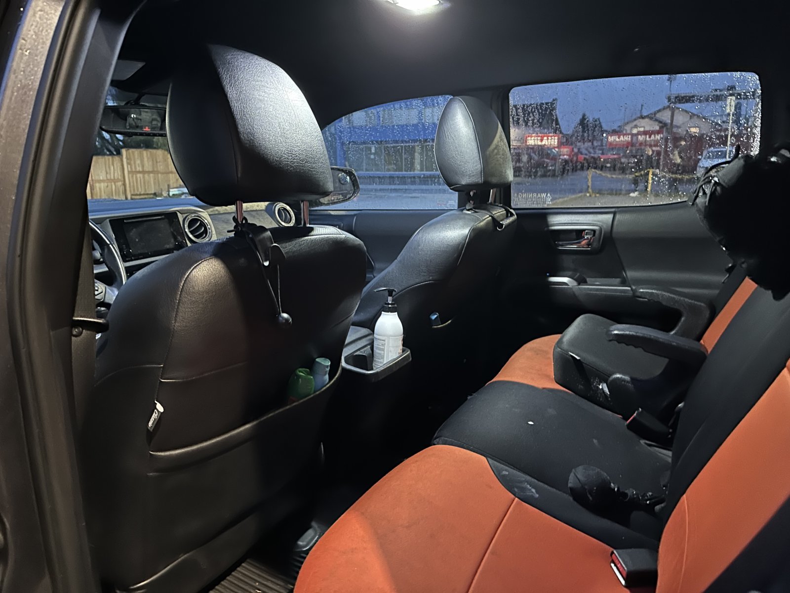

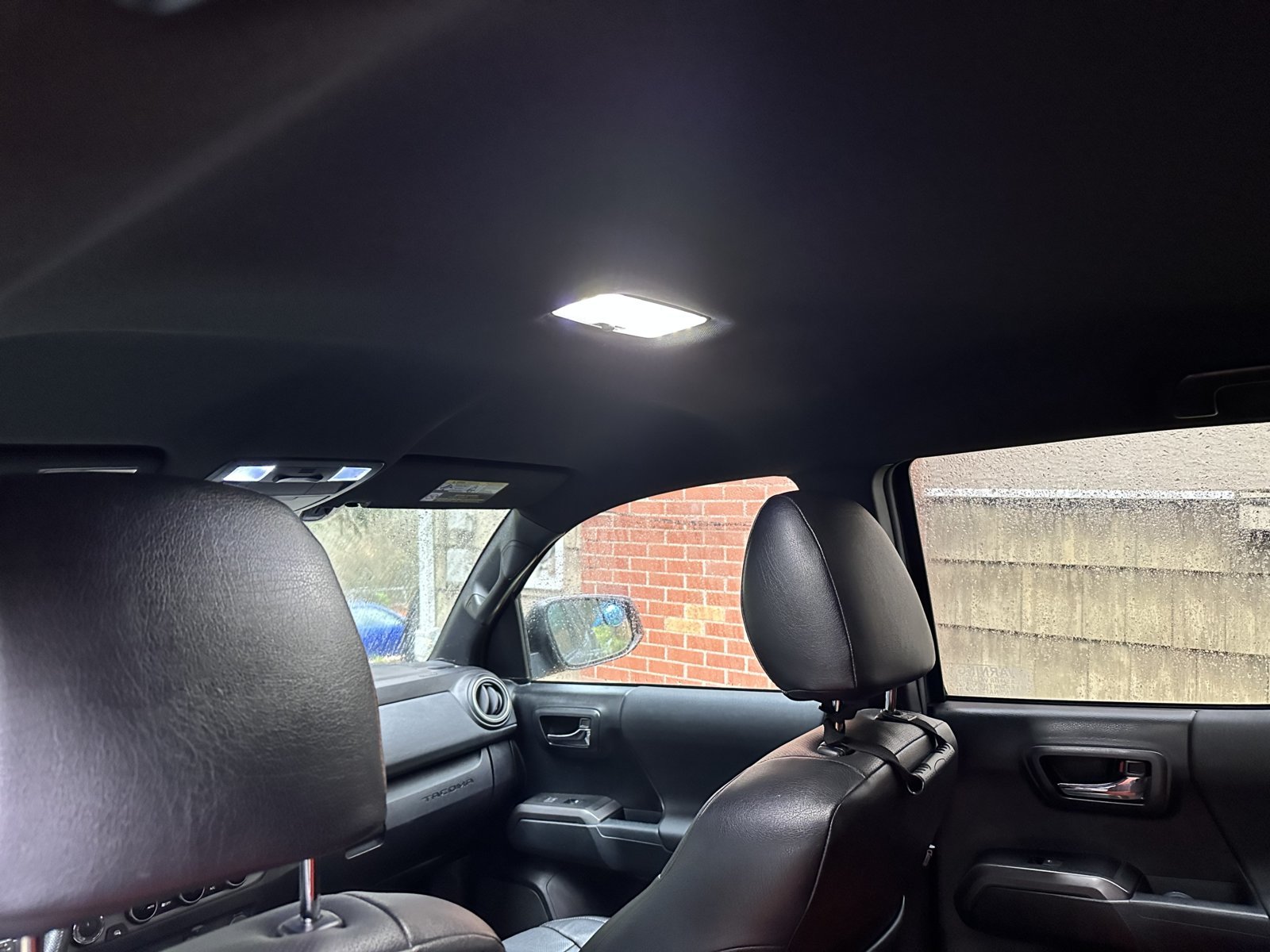

    Night shot, not overly bright but enough to see the floor. No gremlins for now.
