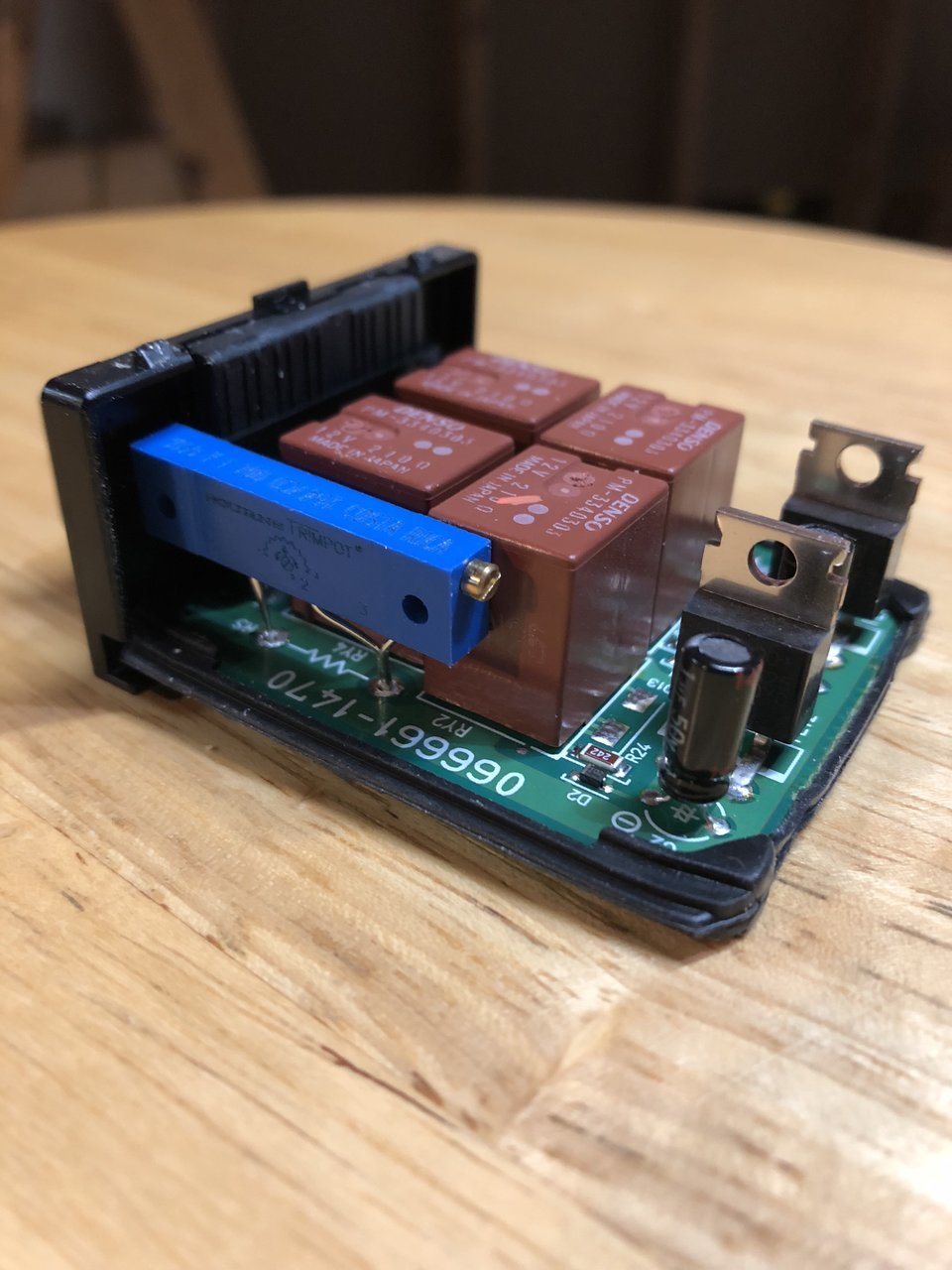

    I have an extra trim pot resistor (the same one I used) BNIB if someone needs it. $6 gets it shipped to you.

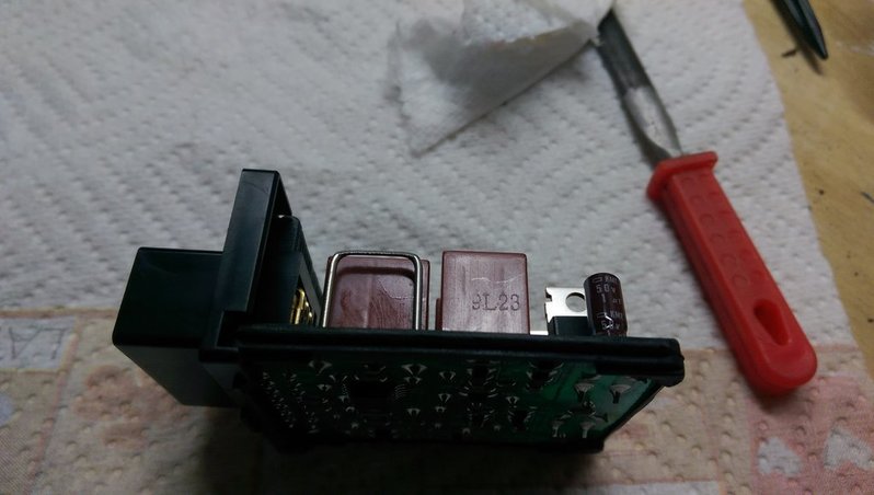

    Can someone post a picture of the completed ground down loop for reference?
