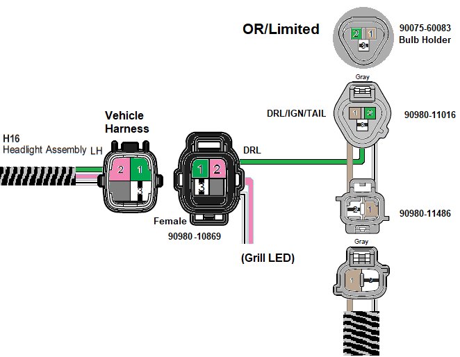

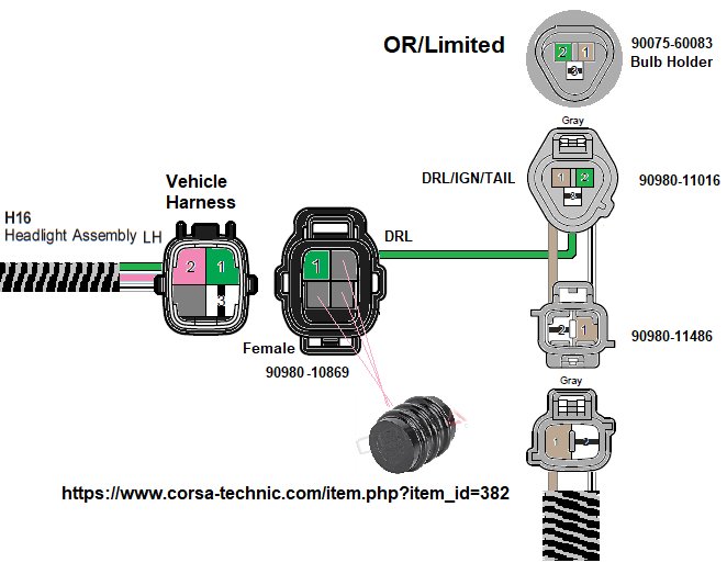

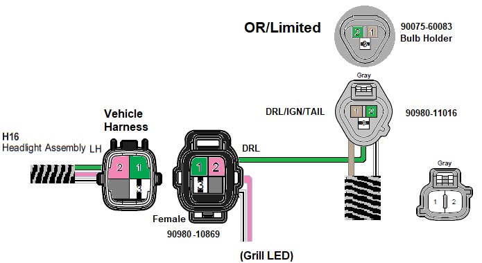

    The bulb holder (3 pin) and connector of the rear STOP and TAIL bulb fits into the turn signal hole of the SR headlamp.
    You could de-pin the turn signal and insert these into the new (rear) connector. The missing DRL input can also be de-pinned and inserted into the new connector or better yet, a matching connector with a pigtail for the DRL input to the new connector. You'll have an additional Parking circuit source with ground for other lamps, like the grill leds...

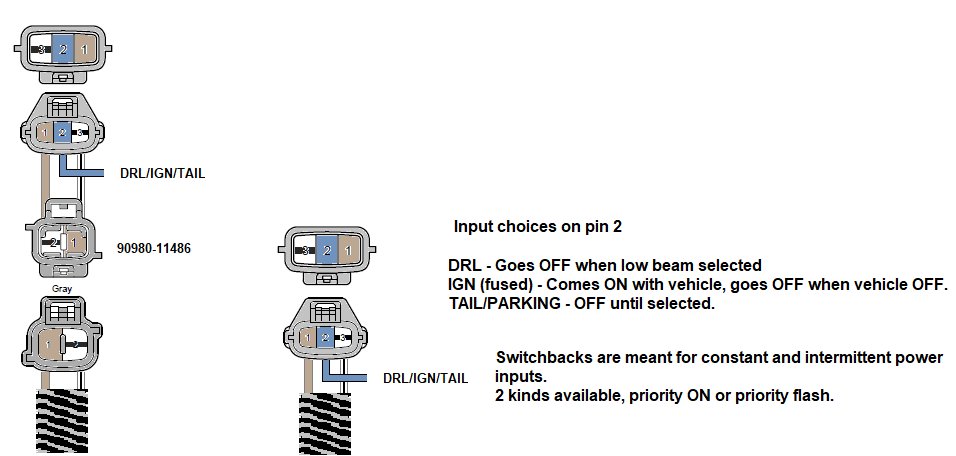

    I don't know what way you went with for the "down" grade.
    The SR uses the low filament as Parking illumination (doesn't go out when headlight low beam is selected) and the high filament for Turn and DRL and the bulb shares the same ground.
    Since your vehicle has the DRL on a separate circuit you loose the parking circuit on that bulb, which the switchback need.
    I suggest you remove the input from the DRL and replace it with a fused IGN source, that way the switchbacks will be ON when vehicle is ON and flash when turns are selected.
    The DRL's go out when the headlight stalk is in the headlight low beam position.
