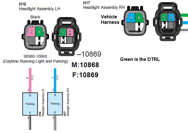

    I know @caribe makaira would have this, but figured maybe someone might beat him to it? Does anyone know the pin out on the factory LED DRL (for the OR, sports, and such...) and a part number on the connector?

  2. Sep 21, 2020 at 7:02 PM
    11,785

    @caribe makaira for the win! I was foolish for even thinking there would be a contender :thumbsup:

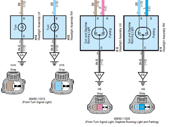

    Caribe, do you happen to have the pin-out and part for the turn signal on those as well?

    "Those" do not have turn signal input...

    The headlights, not the DRL. Don't the headlights still use an amber incandescent? I am assuming a 7440?

    Also, parking in this case is the dimmed DRL, correct?
  7. Sep 21, 2020 at 7:52 PM
    11,785
    Yes, SR/SR5 use 2 filament type the Higher end use one filament type
  8. Sep 21, 2020 at 7:54 PM
    11,785
    Correct, do not forget the marker lamps on the ends off the headlamps also.(parking)

    So left is higher end, and right is SR/SR5?
  10. Sep 21, 2020 at 8:01 PM
    11,785
    Yes
  11. Sep 21, 2020 at 8:04 PM
