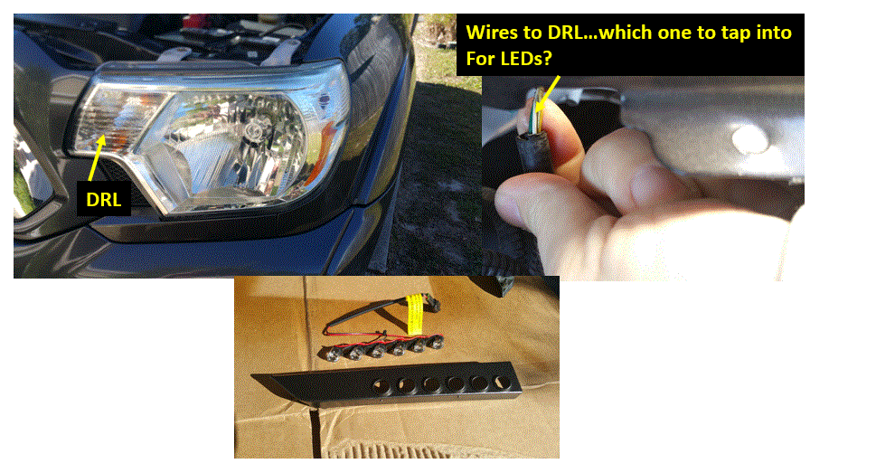

    Posting here also:
    I purchased the kit from Amazon a few years back and for some reason per the way things go these days, just getting around to installing them. I want these to come on when the DRL's are turned on and stay on when the headlights come on also. This is the kit that does NOT have the dash switch, it is the kit to tap into the truck's DRL wiring harness. There are 3 wires that connect to the DRL lamp: green, white, and yellow with white stripe. I don't want to interrupt the turning signals at all...like not of us would...but want to make sure I tap into the correct wire to install the LEDs...soooo which wire to tap into?
    Thanks
