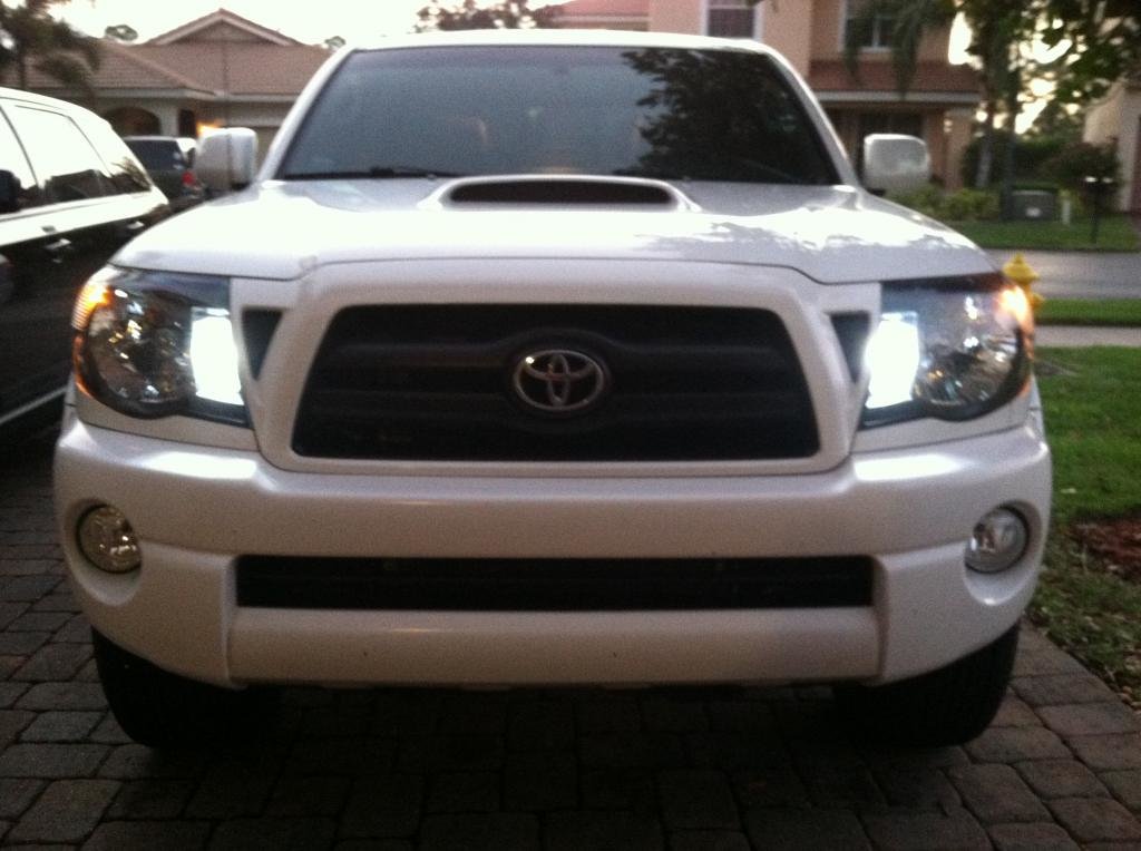

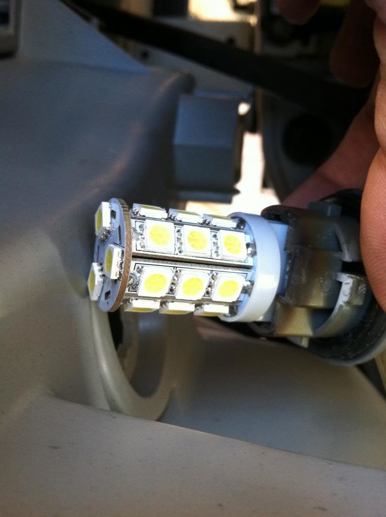

    I recently installed white LED daytime running lights / turn signals on my 08 Tacoma. The heat from the old orange 4157A halogen bulbs burnt and melted my factory headlight lenses. I replaced the headlight lenses with black ones and didn't want the bulbs melting them again. Once installed, I got hyper flashing which is common with the lower resistance (ohms) of the LEDs as compared with the filament bulbs. I used 360 degree 3157 LEDs from Putco. They aren't as bright as the filament bulbs during the day, but they look great at dawn or dusk. To fix the hyper flash, I bought an LED load resistor kit, which are 6 Ohm 50 watts resistors. I just spliced them into the DRL / turn signal hot wire and brought that to ground. My turn signals now flash at regular speed.

    That socket sure used to take a lot of heat, such a bad design from factory

    Yeah, the factory should have run the running lights on one filament and the turn signal on both filaments instead of both filaments on all the time. Maybe it's like that on the newer models??

    I had to replace my sockets and bulbs on my '08 a few months ago. A bulb wouldn't even stay in the socket it was so fried.

    I would be cautious of how hot those resistors get before I affix them to anything plastic or any existing wiring. Otherwise it looks good.

    Those big white blocks are pretty solid insulators (not plastic). Should be fine. The actual resistor is tiny compared to that thing.

    Chris did mention that the resistor needs to be mounted to metal .
