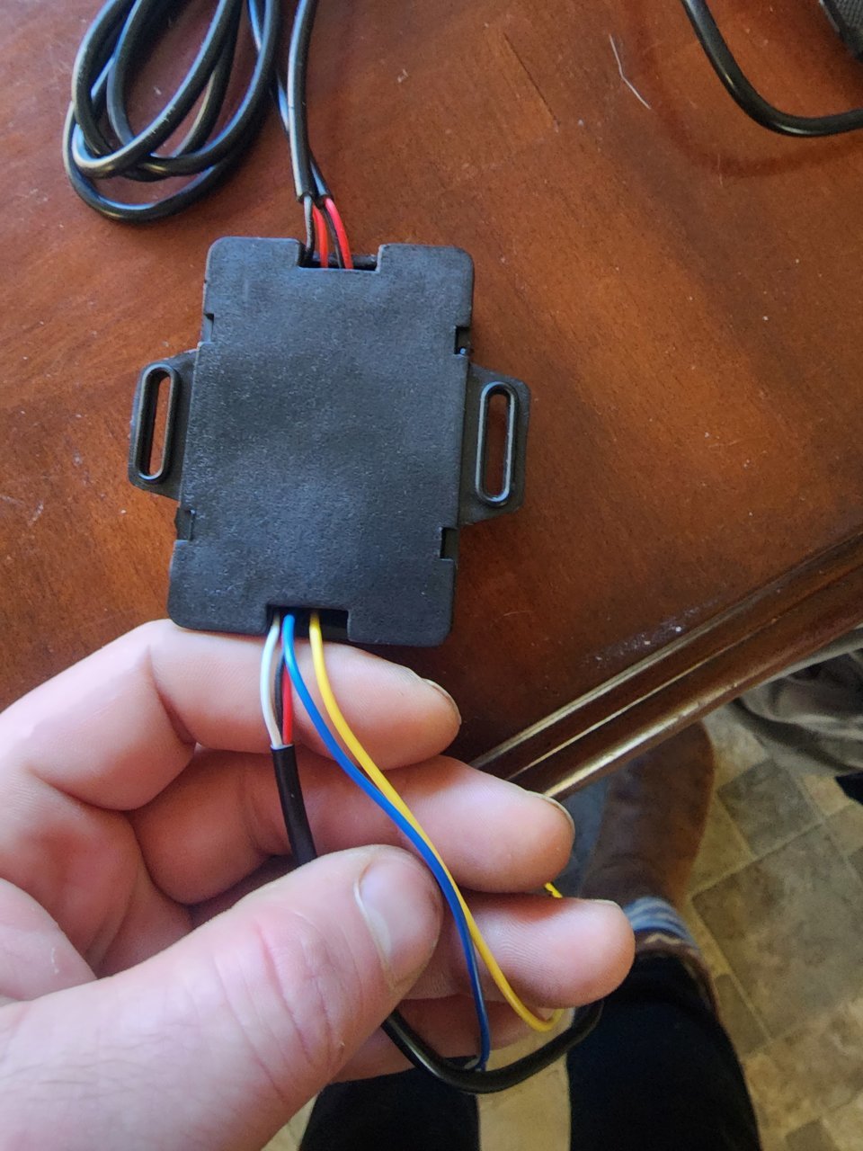

    Has any one else recieved these and the shit instructions they come with? Also how the hell do u wire it. Can post pics if requested.

    So the wires in my hand go batt/ground/relay? Had a buddy translate and he said
    "white is for main light positive, orange/blue for transfer positive, red for ACC and black is ground"
    Any ideas where I should run each besides the ground.

    Something like this being up close and in person is much better.
    Can your friend help?
    Did a Switch come with these lights that allows the circuit to energize and allows you to toggle between White and Amber?
    Did the Relay come with the light as well?
    Any schematics or directions pictures might help.

    No switch, no relay. Got these last night, not much better instructions....only shows fog light removal which is easy....not where to wire.

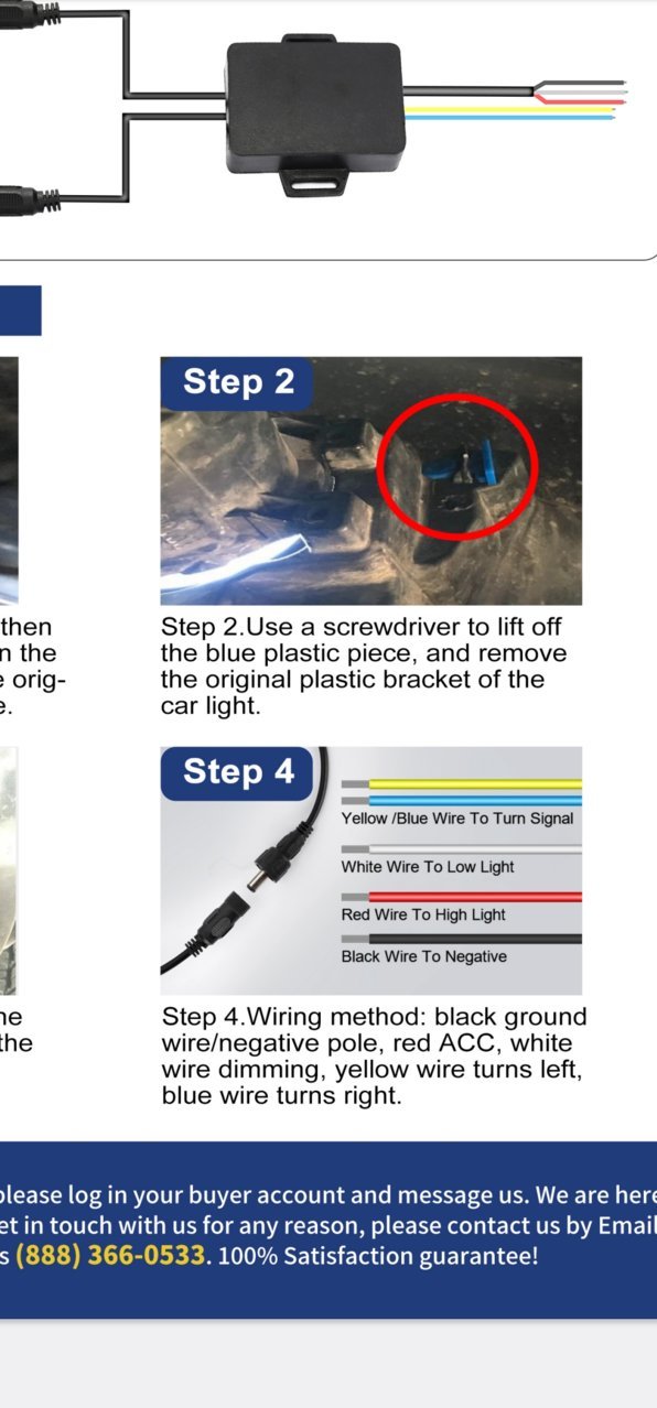

    These instructions have these lights setup as turn signals is that what your looking to do??
    One of those things up close in person it would be easy for me to figure out just what you would like to have these lights do.
    Anyway you can return them and go with a better option?
    If I was close I would be glad to help.

    I would like them to be fog lights, if they blink also that's great....just not sure where to chop these into...

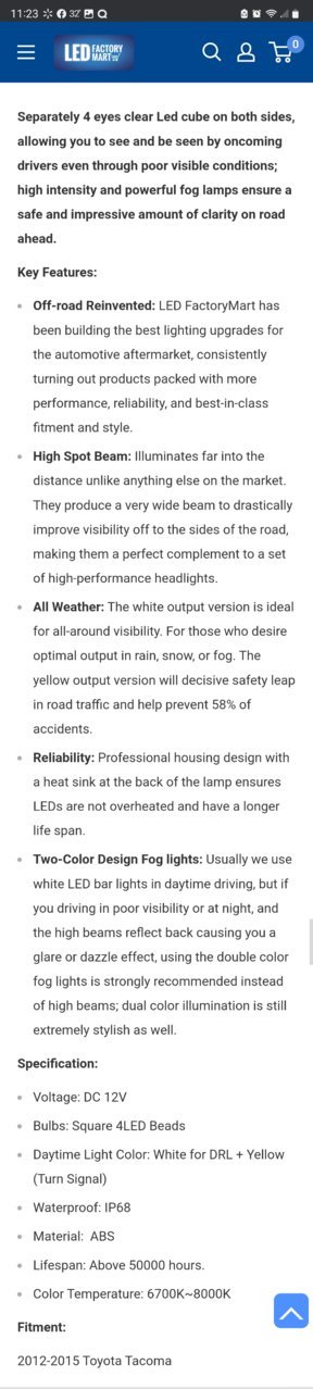

    From the website, of course customer service is non extent, can't even return or refund...lights seem decent quality.

    Roxmad foglights wiring: Black for Negative, Red for Positive, White for DRL Positive, Blue and Yellow for Turn Signal Positive.
    I went with the Reverse Light Wiring Kit and Tacoma-specific harness by Diode Dynamics to hook up my rear pods with backlighting, but a special harness really isn’t required for these Roxmad lights.
    I just bought H11 plug adapters, connected them to the red and black wires of the Roxmad lights, and then plugged them into my OEM foglight plugs so I can turn them on and off with my OEM switch. The white, yellow, and blue wires are tapped into my DRL/turn signal wires.
    I really like how these lights look and I’ve had a lot of people ask me where I got them.
