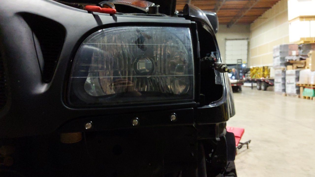

    Perfect I will get one of those guys because I just redid my turn signals. The 3 eagle eyes on the bottom are now turn signals.

    Mine is a 2000 it was just plug and play I run 4 LED lights up front and the stock 1156 bulbs in the rear

    Sold 2001 tacoma prerunner 4x4 conversation 09 taco
    Snorkel
    Where did you get those led inserts ?
    looks solid
