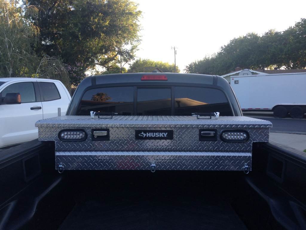

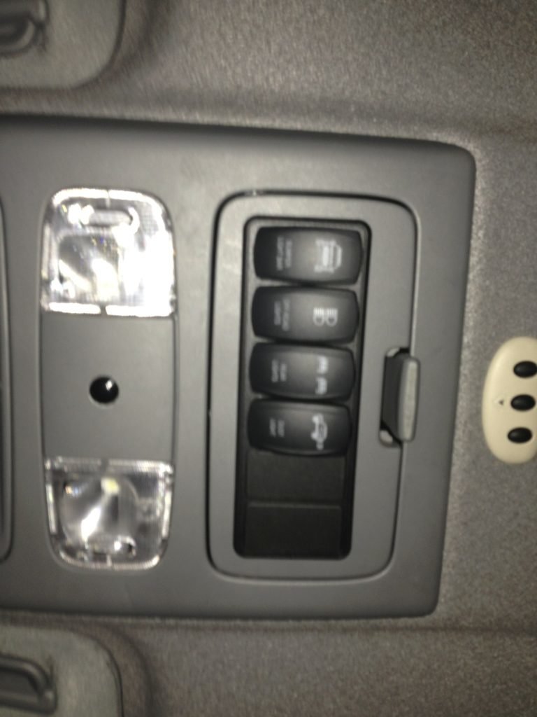

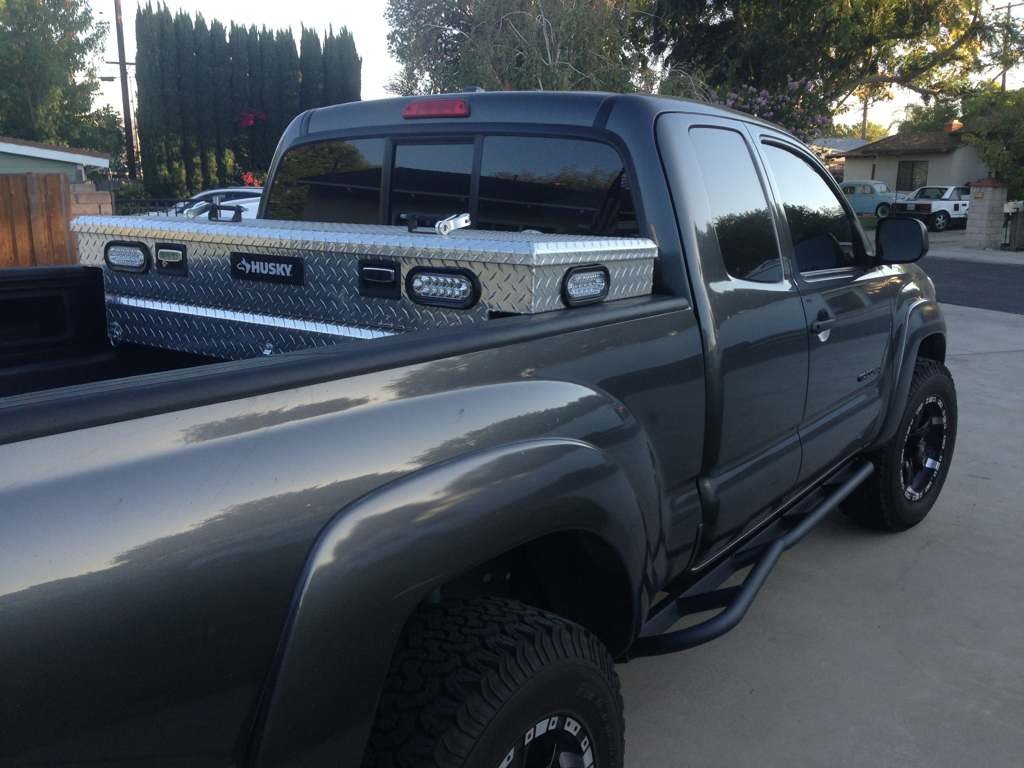

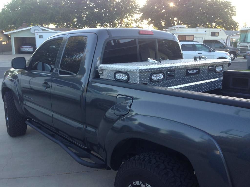

    Alright guys, met up with Anthony (ProForce) last Friday. Got all the wiring installed and the switches and module as well. Everything went fairly smoothly and works exactly like we had planned! I took a few videos of the lights in action. They flash when the switch is turned on, have a pattern select momentary switch, and also operate as turn signals and hazards.
    I am very pleased with everything, and if anyone needs any wiring done that is slightly more complicated then what your comfortable with, go see Anthony! He has great subject matter knowledge and fair prices! We worked on this from 10am to about 10pm, although we had a 12 pack and got food and took a few runs to the store for extra supplies, it was a great time! Thanks for everything again Anthony I appreciate it!
    Flashing:
    http://youtu.be/mmJxzjrNcU4
    Turn Signal:
    http://youtu.be/JM-PEkYdaf8
    Switches: (Terrible Night Time Photo, will get a better one tomorrow hopefully)
    Hope you guys like it!
