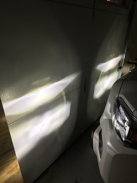

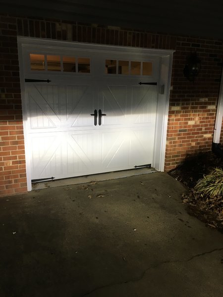

    It's difficult to see where the cutoff of the fogs is...did you know you can turn on just the fogs by using the parking light option with fogs on? Try that picture to see where the height is at that same distance.
    If it's higher up on the wall than the height of your foglamps, the beam is extending upward, and if it's extending upward, at some distance, it will overtake the low beam cutoff
    My kid could have probably drawn this better but the top illustration is roughly what they should be doing.
    The bottom appears to be what yours are doing. At distance A like your first picture, it appears okay. At B it still doesn't appear to be overtaking but is showing its upward angle, and at distance C is where oncoming traffic is and is having to look away because they are in the path of the light.

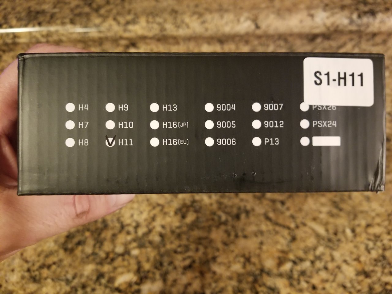

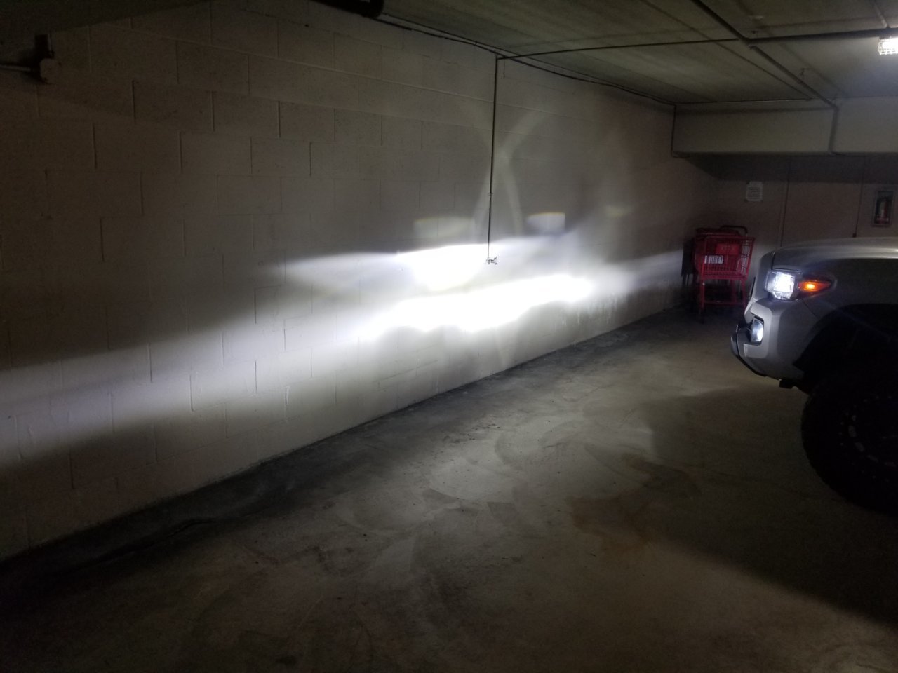

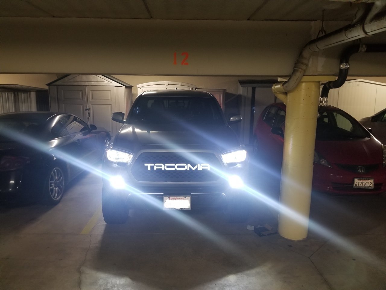

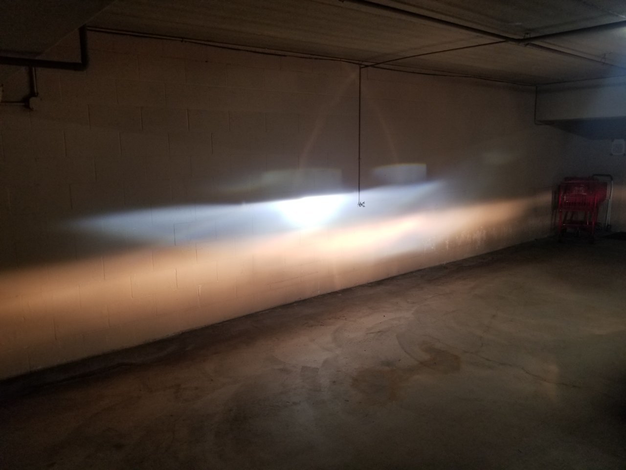

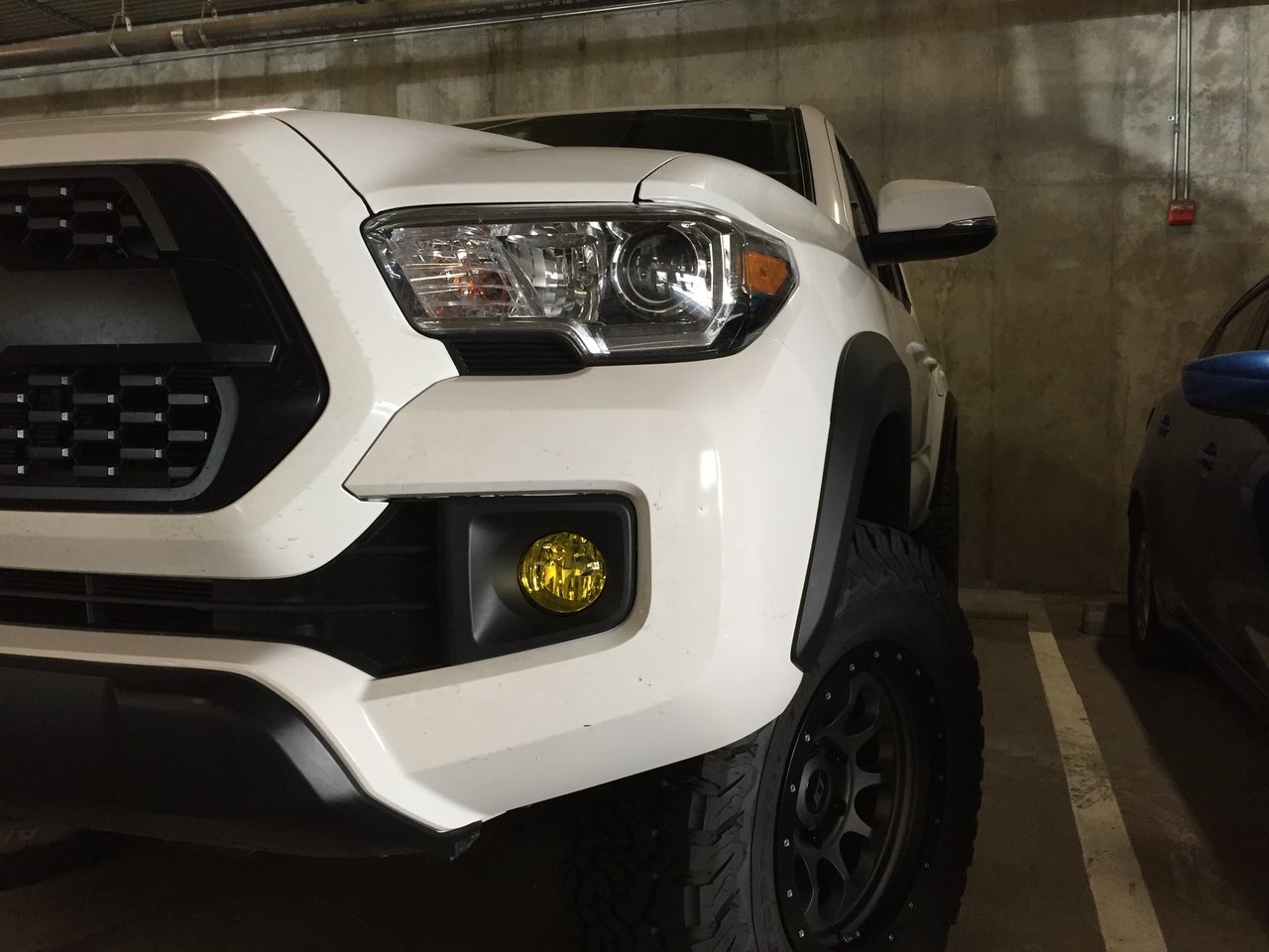

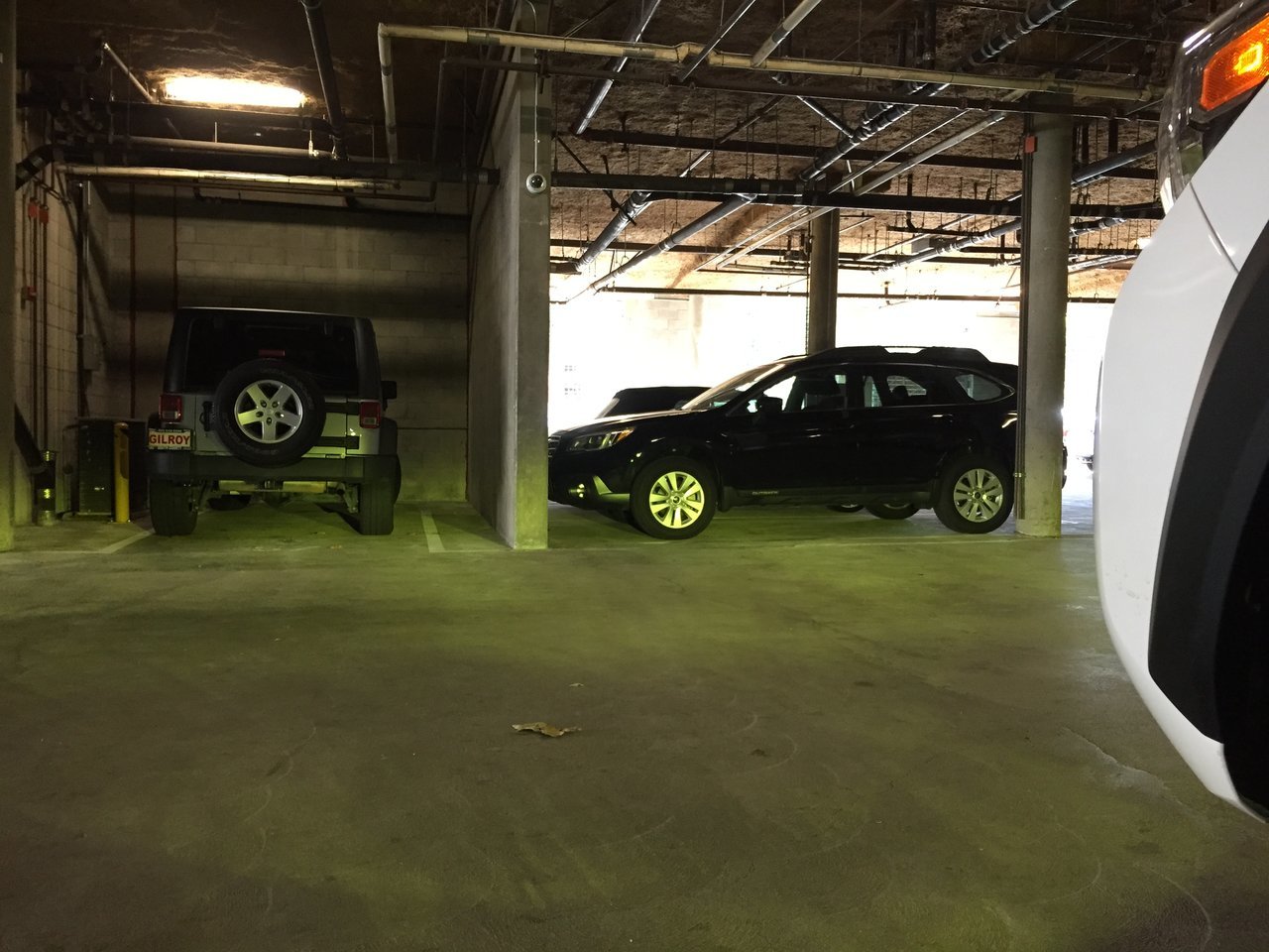

    After doing some research on bulbfacts.com, I decided to try the Beamtech H11's ($36.99 on Amazon - link below). After reading everyones posts, I was concerned about blinding everybody from putting LEDs in the stock reflectors, but I decided to try it anyway. First with the low beams, and when those turned out great, I bought another pair for the fogs. Both worked GREAT! The Beamtech LED H11's place the LED's in the same location of the stock filament bulb, so my cutoff lines are actually the same! Very happy with them and crazy bright! I'm attaching before and after pics, mostly for comparing the fog cutoff lines. I forgot to take a pic of the cutoffs for the stock bulbs, but you can clearly see the lines with the low beams anyway. Biggest reason I wanted to do this is because I upgraded to a DBCustomz grill with LED lighting up the TACOMA and the light colors didn't match. VERY happy with how it all turned out!

    The LEDs don't have glare in your low beam headlights because you have projectors, while you lose distance projection with LEDs you don't blind anyone due to the light shield of the projector. Your fog cut off is no where near the same.
    You do realize the giant orbs on the wall in this photo, not present in the stock fog photo, is massive glare. This is exactly what you were warned about and why you should not run LEDs in halogen reflectors. This is about as far from 'great' as you get and now you are 'that guy'.
    Again, photos demonstrating significant glare from the fogs, not brightness.

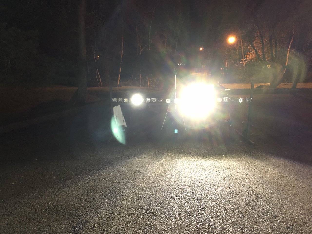

    Baja Designs will be even worse for the fogs, they have no cut offs. Here is a Rigid Fog pod on the left vs a Baja Designs wide angle pod on the right, both nearly the same output. Rigid has clean cut offs to not emit glare and produce a brighter fog beam, while BD has no cut offs, emits terrible glare and has lower output in the fog region as the beam is spread everywhere and not focused. If you want to run a pod in the fog location on the street you want to look for SAE J583 Fog pattern, or look to Morimotos or KC G4s replacement fogs.
