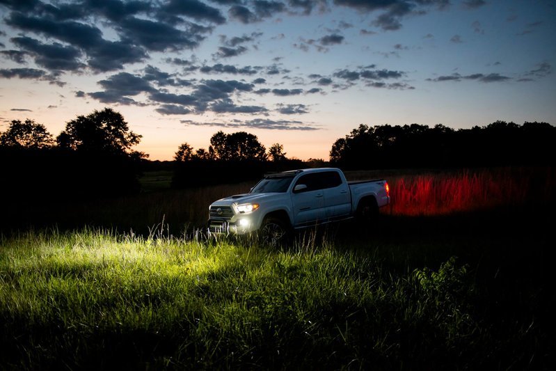

  11. Feb 14, 2019 at 3:27 PM
    #91
    ICU1
    ICU1 Well-Known Member
    Sep 3, 2016
    #196340
    4,531
    Rigid
    TAC1 likes this.
