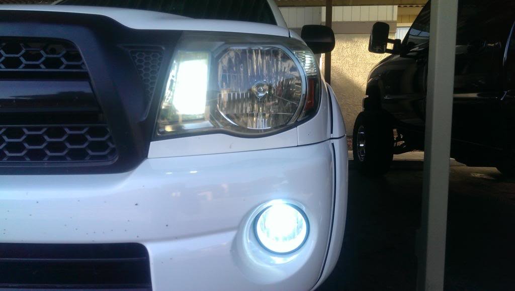

    I've got the white/amber l.e.d. switchback dtrl, white l.e.d. corner parking lights and white l.e.d. fogs, all from csjumper2003. The all white lighting looks really good on a white truck. You do lose a lot of functionality from the fogs though

    Chris has some awesome stuff, I got the switchbacks from him and the white emitted from it in the dtrl at night gives off a dim flood light pattern. Bright stuff :cool:
    Oh and to contribute to my own thread, I ended up getting white led, really just for show. I don't have much use for them but it looks good paired with switchbacks and fog anytime mod.
