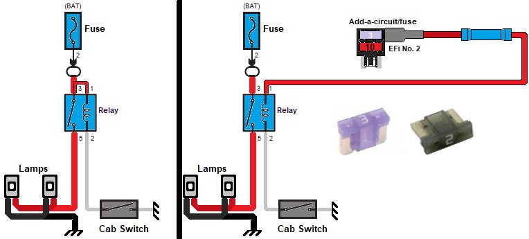

    I feel okay with always able to turn on since I've always had some sort of ditch lights like that, and I think thats the easiest wiring right? If the other options are relatively easy to wire I'm all ears.

    What ever your preference. All are easy as long as you know how to.

    I know how to do the always on wiring. Is youtube my best option for learning the only on when ignition is on?

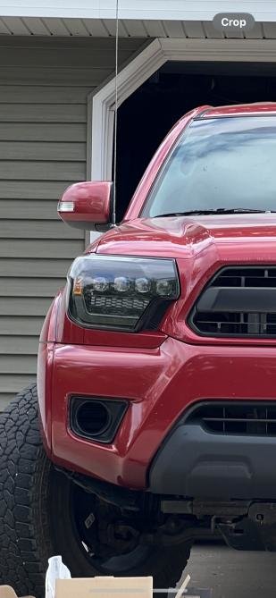

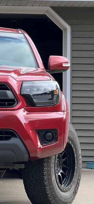

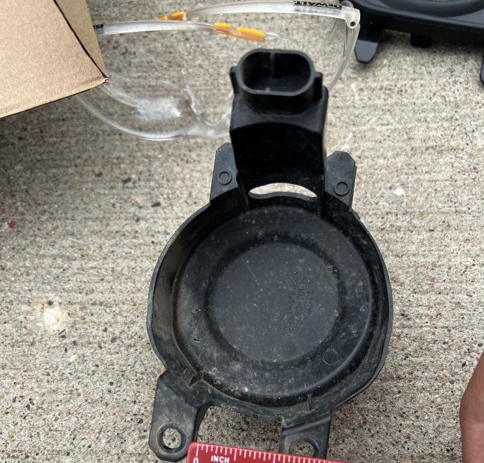

    I have a 2015 tacoma that didnt have fog lights also. That circular cover does in fact come out so you wouldnt need a bezel. I was thinking and am still debating on if I should get DD SS3. I really like how they look and everything I heard its more of just a visual thing like I really like my red and black theme with the truck and I kinda feel like yellow would throw it off. But I have been told you can get a wiring harness off of cali raised and buy a switch from them. Thats what I would do, I still dont know if the yellow is gonna throw it off to much but a 8 year warranty is pretty good too.

    Nope, EFi No2 fuse is IGN. But it also has the "feature" of a leak test after engine off. Might freak you and neighbors with ghost having lights ON after engine is off....

    Add-a-fuse can also tap the Low beam(s) fuse(s) for an OEM behavior.

    I bought the alpharex but I just had a whole issue with them with stuff missing and them not fitting, I liked the black housing it flew with the truck I am just not sold on how DD would look but everything else about them I am sold on. I think it would work with the Caliraised kit because on the DD SS3 in the description it says "Wire adapters are included to connect the lights to your factory bulb sockets - no additional wiring needed!"
    Image attached is with alpharex fog lights

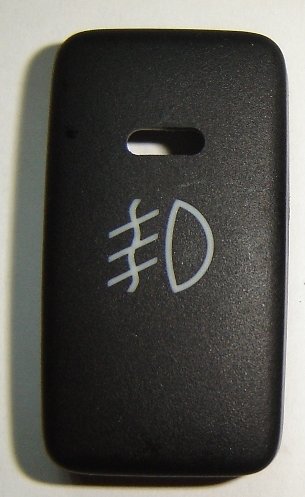

    FJ FJ TACOMA
  16. Oct 11, 2023 at 6:33 PM
    #36
    caribe makaira
    caribe makaira Well-Known Member
    Feb 13, 2011
    #51121
    11,796
    Caribbean, Puerto Rico
    05 PreRunner TRD Offroad AutoTrans
    Hood Struts, My version Fogs always ON, Map & Overhead Light Mod,

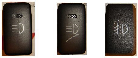

    Modified Tacoma fog switch face plate:
