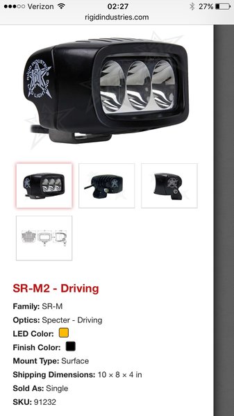

    All of them
    They are in order next week I'll have pics
    They don't work with the D series lights the are he SRM series

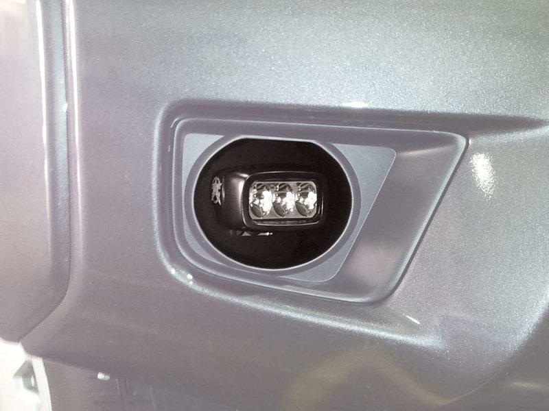

    What's going on with the bracket ?????????????????

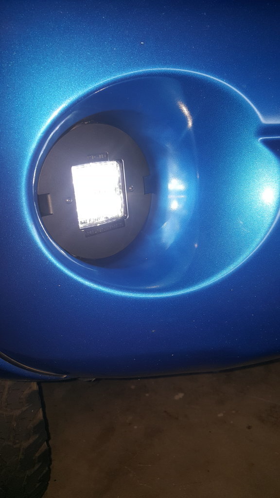

    You wont be disappointed with the dot fogs from rigid. Their mount honestly sucks. You have to bend the tabs in first and use a thicker washer than the one supplied by rigid. And no adjustment. So the best way i found was to mount it as far out as the bracket arms allow and then aim up or down. Only way to keep them aimed down for opposing traffic.
    With their washer, the bracket is deformed.

    It really surprises me that after 10 years of these Tacoma's being out the the road the best the aftermarket has come up with is a round piece of metal to mount a square light...

    Wow, that is too bad that you have to do a little extra. Would have thought with it being RI that it would have fit like a glove.
    Was the wiring just plug and play?

    No it isn't. You either need to cut and solder or get an adaptor like the one i use. And definitely doesn't fit like a glove. Maybe OJ's glove.
