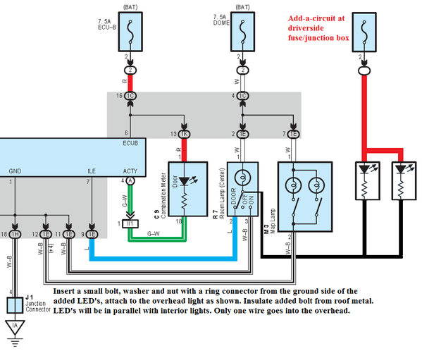

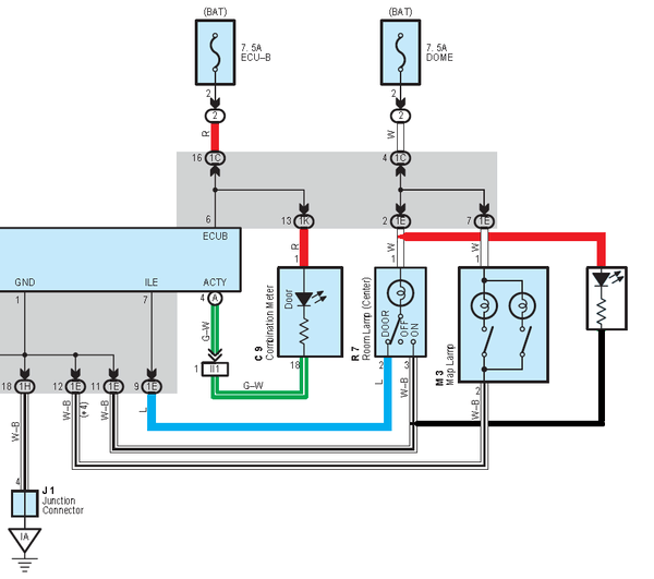

    So I had to run one wire from ground side and one going to the white wire from the dome light. I tried the blue and white/black and was always powered on. I also tried the other blue wire and then with the blue wire and it would stay on all the time eventhough one thread said it would be automatic but no go. Just go with ground side on dome and white wire for + and you should be good. I did white LEDs by adding 194 bulbs instead of strips. Will add pcs in a bit.

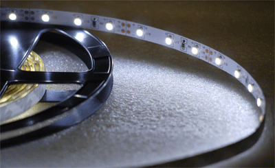

    Just bought these strips. There really bright. Im wirring them to a switch. Theres going to be lights on both drivers and passengers side and in the front consel, under the ac control.

    http://lightsandparts.com/products-page/3528-led-strips-120-ledm/cool-white-strip-3528-led-120-ledm/
    Where I bought them from in Vancouver. $24 for 4 ft. They are the WLFS. If you look inbetween the LED's in the picture theres 4 yellow dots. It gets cut between the 2 and thoes are where your wires get soldered. Im doing mine this weekend, will do a how to.

    I should have also mentioned that I have the Map Lights on with dome light mod found here http://www.toyotanation.com/forum/1898180-post158.html or here http://www.customtacos.com/forum/showthread.php?t=95608. That is how I was able to attach a ground wire from the end of the dome light and used the WHITE wire to get power to the lights also. They look amazing in real time so hopefully this helped. When I finished this it felt great since it took about three hours to figure this out on my side.:facepalm:

    The first pic shows what I did but I was trying to do the one you show second but the info I got was incorrect so just went the two wire way. I will also be adding lights to the backseat so that should be simple now that I have the front set up.
