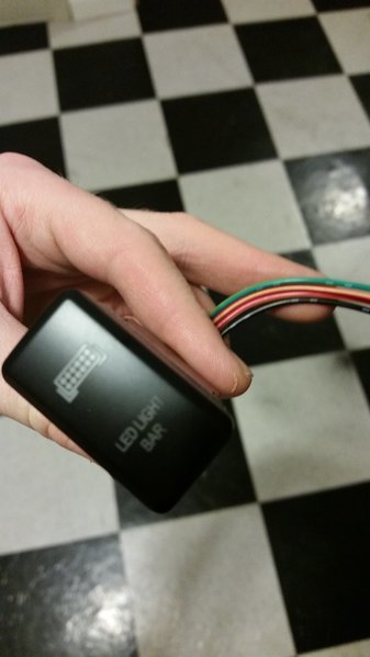

    I have a led light bar with harness ect.. it goes to a push button on off switch. However I bought this switch and it has 4 wires......
    Can anyone tell me how i should wire it up....

    The switch your using only has a 3 amp rating.You will have to power your light bar
    through a relay.Mictuning online and cruiserheads will have a diagram for your switch.

    OP states that he has the light bar with harness, so personally I would think that he already has the relay, especially since the three wires below the plug are black, white, and blue.
    OP if that is the case, then clip the plug off on the side with the blue wire in it. Black is obviously ground and the blue wire connects to the red wire nearest to the green wire. The white wire will go to the green wire, and then the final wire is connected to a dash light circuit. Most people use the wire that powers the cargo light switch illumination (green and white?) to light up their switch when the dash lights come on. I did the same thing, but I would have to open up my dash this evening to see which wire on the cargo lamp button that I tapped into.

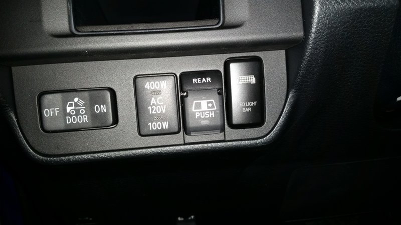

    i ran the wireharness to the positive part of the battery and then took the screw off you see on frame to the right of the battery for the ground. it has a fuse inline.
    since it is off the battery it can be turned on without the car being on....but only then does the light turn on when you activate it ... if its off the switch is off....
    i only ran the 3 wires to the 4 wire switch
    neg
    positive
    light for the switch

    Yes then tbrought the gromet you can see when you are looking on the drivers side

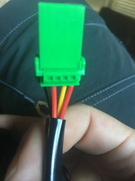

    Sorry to bring back this thread. So I see everyone referencing the green wire. This is the harness that came with the switch that I'm trying to wire to my LED bar (black,blue,white). As seen, my harness is different, as it is Black, Red, Yellow, Red. Anyone spliced this type of harness?
