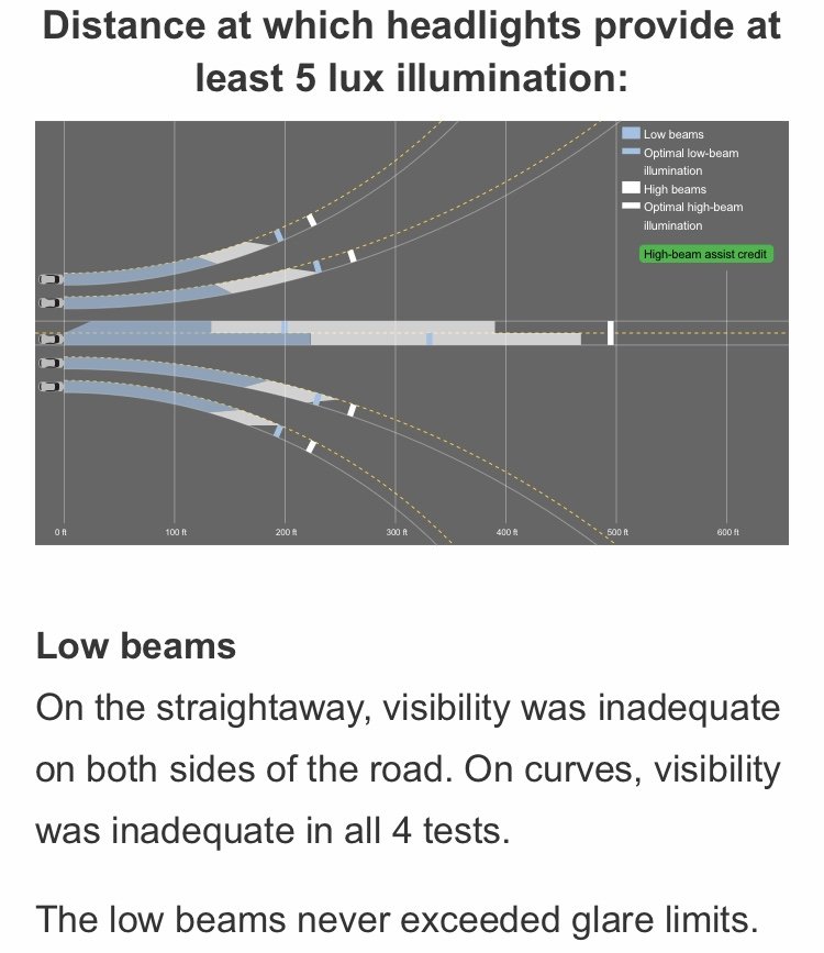

    Are you talking about Toyota? The company that for the Tacoma received a “Marginal” rating for the non-LED headlights in IHSS testing due to poor low beam performance? :rolleyes:
    https://www.iihs.org/ratings/vehicle/toyota/tacoma-extended-cab-pickup/2021
    Worst low beams of any vehicle I’ve owned, I upgraded my stock H11 low beam bulbs to GE (now Tungsram) Megalight Ultra +130 halogens and they are a noticeable improvement over the stock bulbs.

    A single reference point has zero value. IIHS headlight ratings for a few vehicles
    Nissan Frontier: Poor
    Chevy Colorado: Poor
    Toyota 4Runner: Poor
    Lexus ES350: Marginal
    Ford Ranger: Marginal
    Honda Ridgeline: Marginal
    GarlicFarts likes this.

    My last truck was a Colorado, the low beams were better than my Tacomas with OEM bulbs.
    IIHS testing is actual testing not just a “reference point”. You have to look at the charts and the write up not just the rating. I don’t think listing other vehicles with marginal and poor ratings helps your case of your “professional lighting engineer” working for the “largest manufacturer” evidence which truly does have zero value lol.
    My first hand observations are my “reference point”. Tacoma halogen low beam projectors are not very good and IIHS testing proves it.
    Look at the distance for the Colorado Low Beams (halogen):
    Now look at the distance for the Tacoma halogen low beams, much less distance than the Colorado, especially on the straightaway where they were deemed “inadequate”:
    Carry on. ;)
