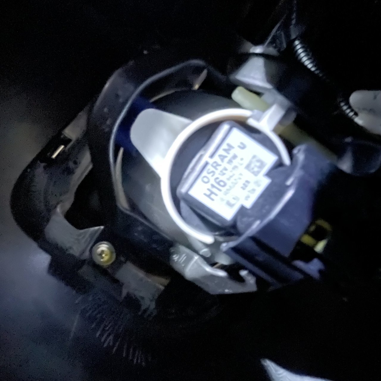

    I would pull the bulb to verify if you have H16.
    Early years OR trim came with a glass housing for H11.
    SR5, Sport had H16. You will need to replace the housing to use H11.

    Bummer, looks like I've got the H16 on my 2022 TRD OF. So my only option is to replace the whole Fog light housing from an older Tacoma that uses an H11 in? Looks like I've got more research to do.

    If the lense is a plastic, h11 is going to be too hot.
    You may go to OEM Tundra/lexus led fogs. You can find them for cheap and they are decent.
