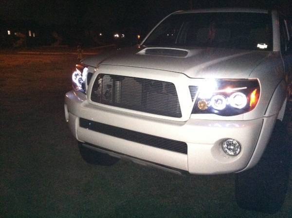

    Does anyone have instructions on how to install the new halo rings and eyebrow to make it a brighter/blue color such as the 3 led going vertical?? THANKS

    As far as making it brighter the only way would be to change them to LED but the wiring is simple since its positive and negative. All I did was grab power from a cable that went to the auxilary wire going from the stereo to the AMP. I tapped into it on the driver side cover that's by the door jamb sinc.e that's where the wire runs through. The ground was just grounded to the ground of the parking lights. If you don't want to run the power wire all the way inside the cab then just grab power from the parking lights. I did it my way because I wasn't fond of having o turn on my lights to have the halos on. Anothernhing is that the HID for mine had to be on a wiring harness since it kept flickering and remember that projector has a more direct light output so you might just need to align your cutoff for the light output o be better. Hopefully this helps.
