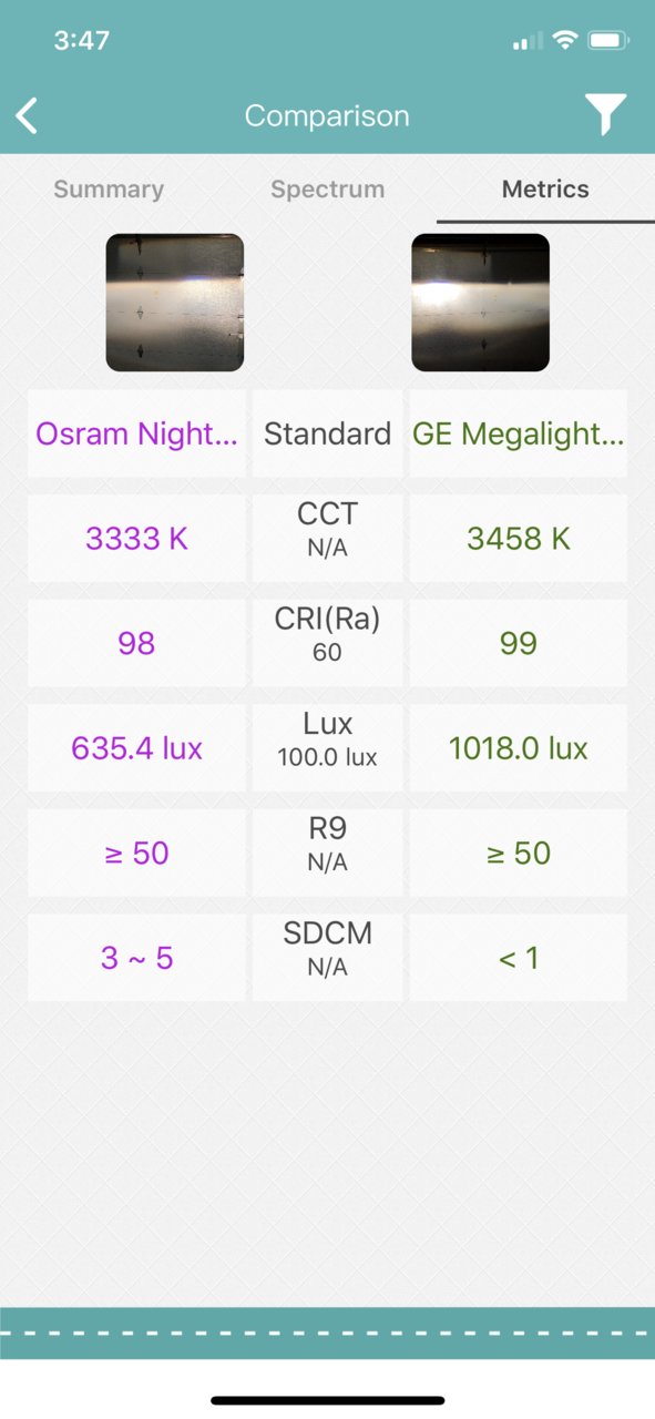

    Only other thing I might add is that the Osram +150s are not that great. It seems like they should be, but I think they have too much blue coating. Here is a comparison between the Osram Nightbreaker Laser +150 vs the GE Megalight +130:
    These measurements were from an H11 bulb, but I would expect a similar performance comparison with an H4. Both bulbs do coat the high beam filament though, meaning high beam performance would be reduced.
