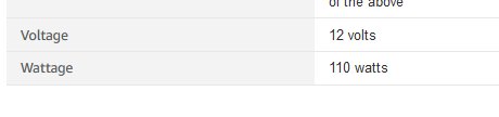

    Wow, those are expensive, would it make sense at that price to just upgrade the entire headlight instead? I keep seeing issues with bad seals, condensation, is that common? Or cheap parts, or bad installation that is the cause?

    Non-reputable LED companies flat out lie in their specs all the time, especially those off brands sold on Amazon. No, it is exceptionally unlikely those are anywhere close to 55w/ea. I've tested some amazon replacement LEDs that are far less than half their published wattage spec, which would put them at the more typical 22w/ea. Also note the design on those is awful. It doesn't replicate a halogen filament in anyway, meaning focus will be poor and glare will be increased.
