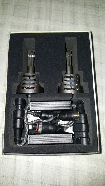

    RSI Lighting is how I'm rollin.... search here for a lot more info.
    2 sets of H11 and 1 set of H9s... I already did a LED upgrade to my fogs so .... haven't installed them cause Plate Bumper @ powder coater.

    There's that (remove bulb replace with new) and there's a small box that has a fused power supply that your OEM wire plugs into. This gets wire tied in the engine compartment somewhere out of the way...
    Plug OEM harness to power supply, plug power supply harness (same as OEM) into new bulb..
    The harder one is the fog light.. easiest if you take off your front grill (10 minutes for that) and do the same install as the headlights and high beams.

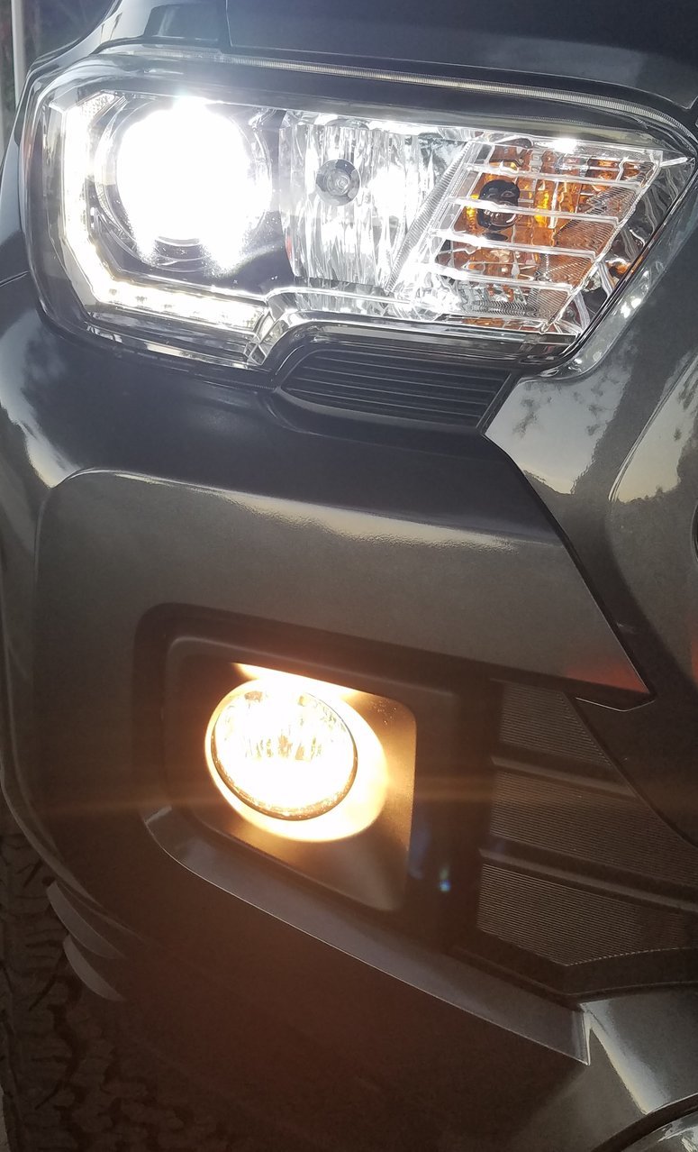

    These pics are they just of the low beam or the low beam & fog lights on at the same time? I switched mine over to led and unless I'm driving with both low & fog on I can't see anything, the projectors don't seem to want to throw the light that well. Considering switching to a higher end led or trying hid's, read somewhere that these headlight housings throw hid light better then led light.
