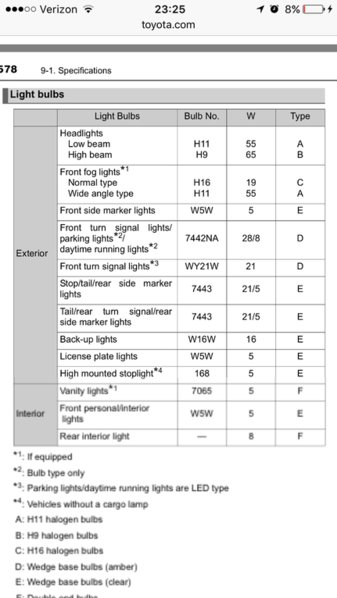

    Page 578 of the owners manual has bulb specs (section 9-1 / specs)

    I had to search to find it online. So for the TRD and up models, low beams and fogs are the same bulb type and wattage. Interesting
