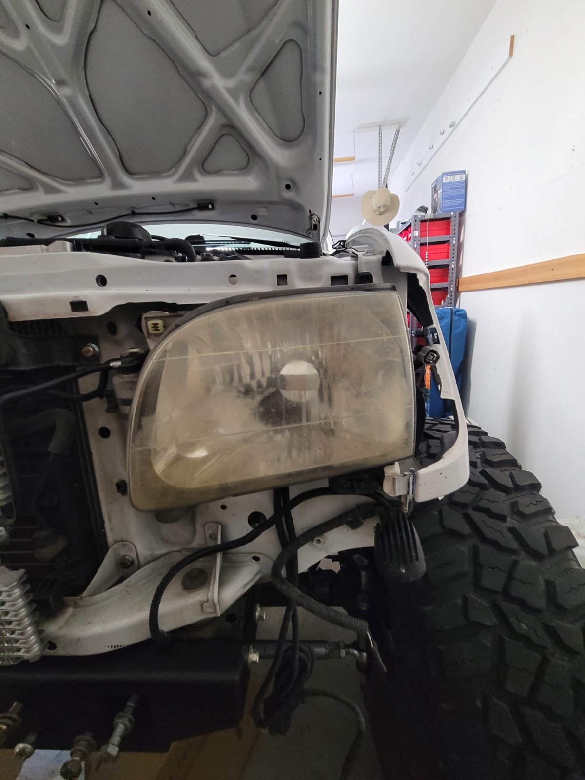

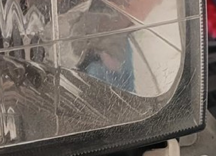

    I polished my OEM head lamps a few times, but those imperfections where on the inside. Eventually, just got new housings from rock auto and called it a day.

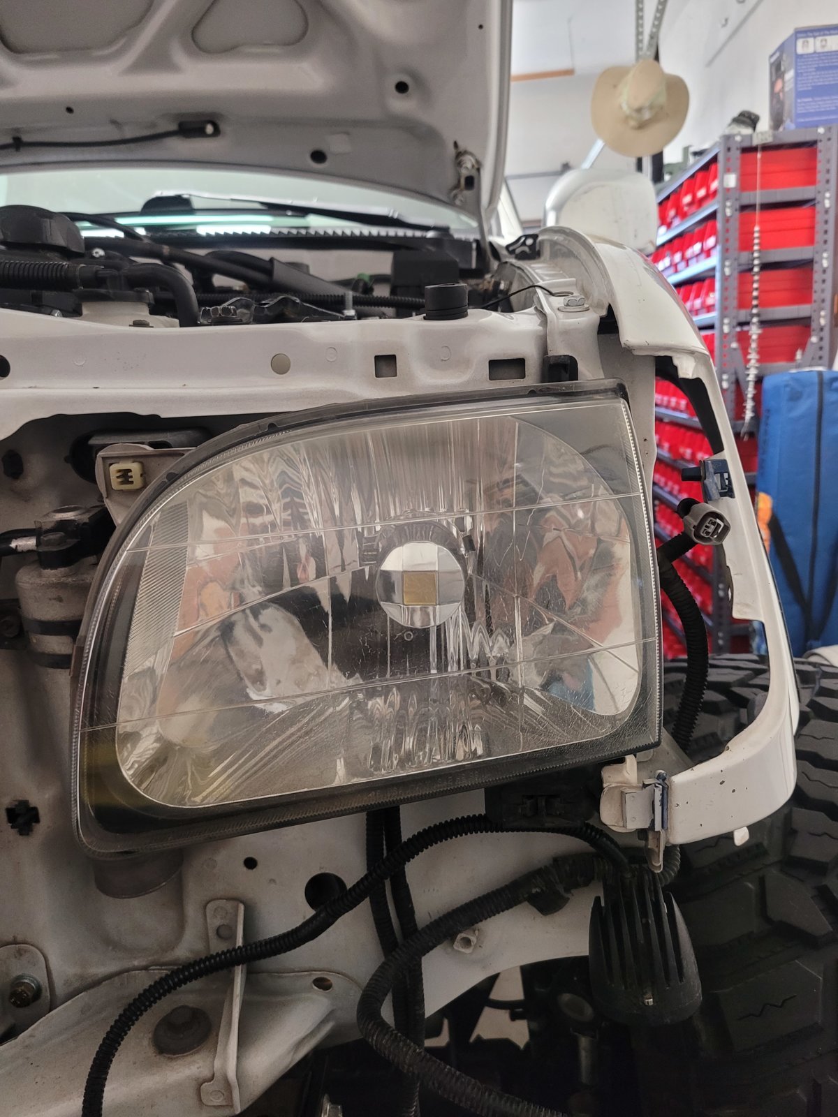

    See post #62, post #69, post #73, and post #242 in my 1st Gen build thread. The best remedy is new headlight assemblies (sometimes you can salvage the old ones, but new will be better) and upgraded wiring with performance halogen bulbs. This will significantly outperform pnp LEDs while also keeping the beam pattern like stock, without scatter and glare caused by using an LED in a halogen housing. The recipe is the same as the 2nd Gen headlight upgrade already mentioned, just with slightly different parts.
