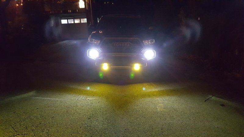

    Morimoto 2 Stroke LED vs stock
    It's a lot more nicer/noticible difference in real life. My buddy on the right is going to get the Morimoto 2 Stroke LED now.

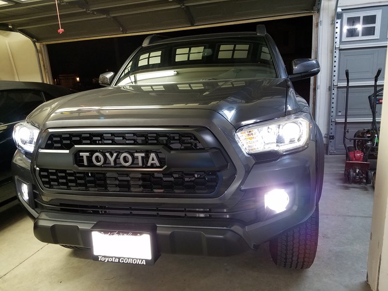

    Morimoto 2 stroke owner here: (and Morimoto XB fog lights)
    They look great, I'll grant you that. I'm happy with them; however, the journey to get here wasn't easy. To start, @TRSAndrew completely ignored me in other threads when I asked about pricing. To date, I have never heard from him. Guess he's too busy to respond to us mortals. Good thing I found an Xmas discount code on their website on my own (no thanks to Andrew), or I'd be hunting elsewhere, but $102 for the set after discount was too good to pass up.

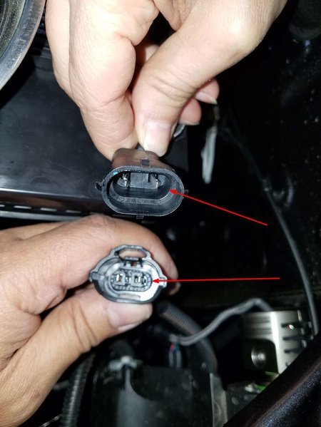

    The second hitch was when I received an incorrect adapter kit that plugs in to the factory headlight plug:

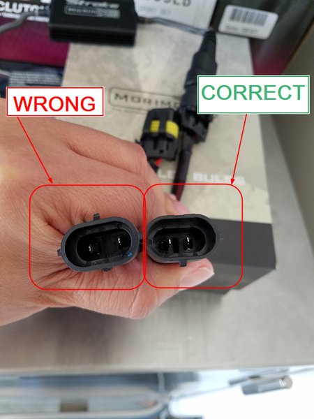

    See the top plug? It's the adapter kit plug and is spaced too wide as opposed to the much narrower factory one. Complete fail. I did contact TRS tech support via email who promptly sent me a replacement plug. TRS tech support (unlike Andrew) was very prompt and efficient and deserve much credit. The replacement harness appeared to be much better:

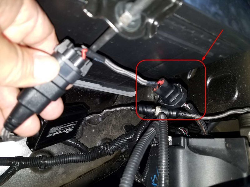

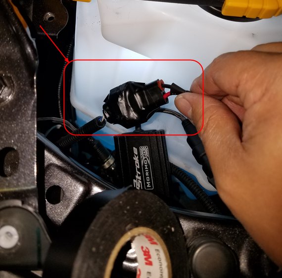

    However, again there was a glitch. The Morimoto adapter plug doesn't securely snap in to the factory headlight plug. You can push it in and hear a click, but if you give the plugs a quick pull apart to separate them (without unsnapping them) your headlight will go out. I can imagine that road vibrations will eventually loosen the plug and cause flickering or the headlight to just quit when the contacts separate. I have seen in other threads of users complaining of Morimoto headlights going out randomly; I wonder if this was the cause. I ended up wrapping up the connectors in electrical tape to keep them secure:
    I shouldn't have to wrap connectors in tape - they should snap in securely. This is a ghetto repair - I wonder why the connectors weren't designed properly?

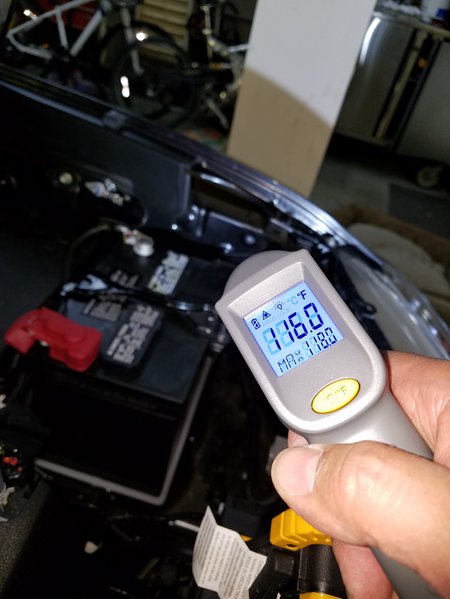

    Once my lights were in and running, a new issue I noticed was the excessive heat generated by the voltage regulator boxes:
    When running for a period of time, the metal surface heats up to around 116 to 118 degrees. To be fair, this is while my truck was stationary, when I retested them after driving around my thermometer reported a more normal 88 degrees. I assume the airflow kept the boxes cool; however, I wonder how long these regulator boxes will last if they heat up as much as they do. Also, what will they do when it's over 100 degrees here in CA during the summer? I think the longevity of these LED bulb kits are suspect. Also, the boxes are not designed with "ears" for you to bolt them to a metal surface to act as a heatsink. I was forced to zip tie them away from other wires or plastic surfaces since I'm afraid of them getting damaged by the overly hot metal regulator boxes.

    Thanks for the night photo, they look great and I'm taking a closer look at Morimoto.
