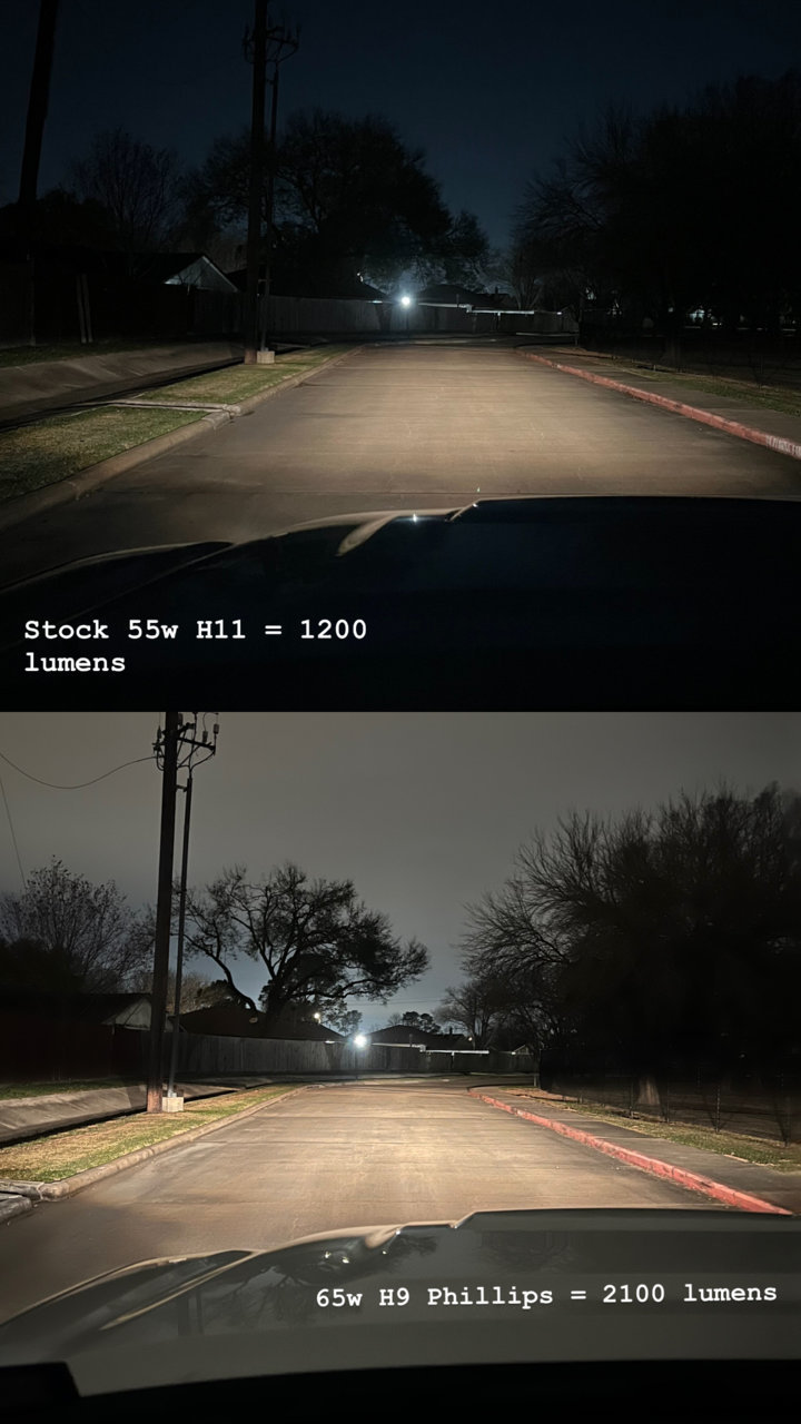

    I have LED fogs and halogen headlights. I can attest, that the H11 to H9 conversion is one of the best, easiest and cheapest mods to do.
