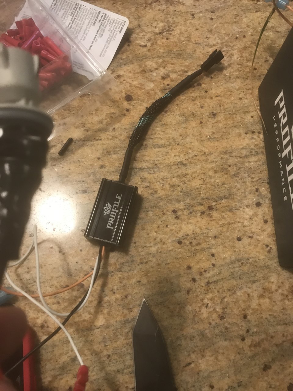

    Only 2 wires coming from light? And do those go to the input or output of that driver? What else is that driver hooked to? Halo or drl board?

    OK, looks like profile pivot halo driver. Wires are hooked into the wires going into the driver. The other person changed out the plug n play socket for some reason. Maybe to use as turn signal instead of marker light. I could be wrong but I don't think it's a switchback side marker light? @MESO Taco

    Looks like a profile switchback strip. I remember seeing these for sale I think, guy switched the strips out to profile to match his halos or something.
    Black and white wires get connected to the wedge connector, orange wire goes to your positive turn signal wire.

    Yeah, def my housing. But someone swapped a profile strip in there. Still a good LED. Colors would be close to the same if guess. Black chassis ground, and white(DRL input), orange (turn)
