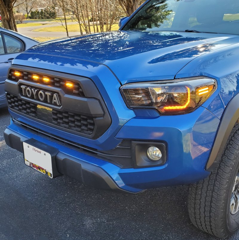

    These stage 2's in all-amber really tie the lights together and make it pop. I think the S2's are the perfect amount of accent.

  7. Feb 14, 2020 at 2:19 PM
    #407
    TheTacoAdventurer
    TheTacoAdventurer Well-Known Member
    Sep 3, 2013
    #111758
    799
    Boston, MA
    2018 DCSB TRD OR
    Forever modding!
    Looks awesome dude
    swils[QUOTED] likes this.

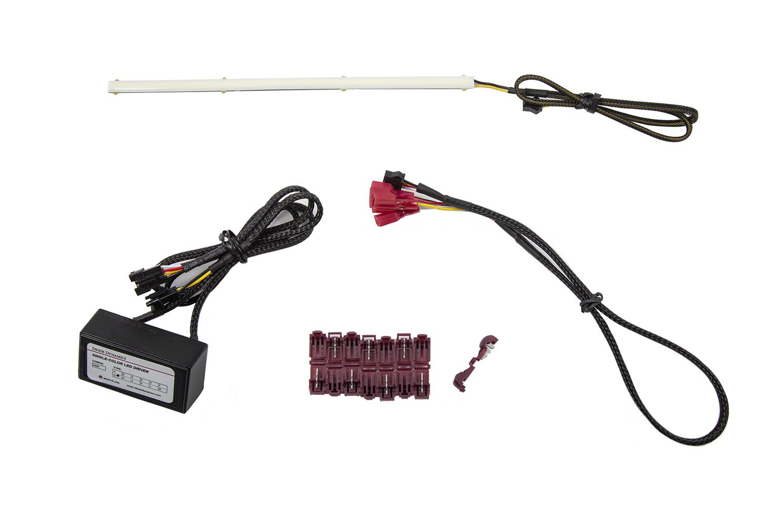

    I'd take a picture but its really hard to see / get to. I hid the driver in my fender so it cant be seen at all without taking the bumper off. Anyways, here's a picture of the driver from the diode dynamics site. The strip in the images is much larger than these sidemarkers[​IMG]

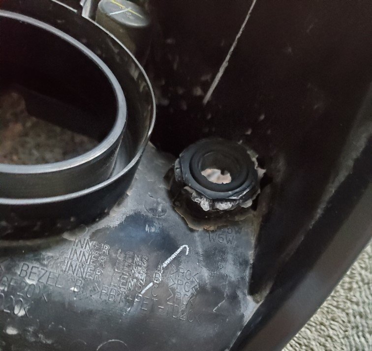

    Here's where I mounted mine (using high strength velcro strips), and how I ran the wires out of the back of headlight, sort-of.
    Driver's side, next to battery:
    Passenger's side, against front wall:
    The old sidemarker bulb hole that I cut a piece of rubber-furniture-feet down to side to fit in, where I ran the sidemarker LED cords through (not pictured)

  11. Feb 16, 2020 at 6:34 AM
    #411
    J_Hacker
    J_Hacker Well-Known Member
    Sep 21, 2016
    #197896
    437
    Somewhere in Virginia
    '19 White Tundra Crewmax
    Bilstein 6112, CB +2 Shackles, Soft Topper, Method 316, 295’s
    That’s what I was curious about. Finding some way to cover that hole that the wire would come out.
  12. Feb 16, 2020 at 7:32 AM
    #412
    swils
    swils Well-Known Member
    Dec 27, 2018
    #277125
    187
    Maryland
    2018 OR Blazing Blue, MT
    The rubber I cut down to size had to accommodate 3 wires (one for each stage 2 LED strip since I went with all ambers, and one shrinkwrapped pair coming off of the RX350 highbeam solenoid), so I had to cut it to ~1cm diameter to fit them all, and I couldn't go with a flexible "X" cut because the sole of the cap was too thick, so I gobbed in a ton of silicon between the wires to seal it up. I'd also originally planned to use the furniture caps to surround the hole, rather than trim it down to sit in it, but the package I picked up was slightly too small. I tried hard to find a 3/4" rubber seal to fit flush, but I think you'll just have to make do. If you're only running a single wire out of it, a piece of rubber stripping cut-to-size for the hole, with a small slit in it should be plenty to fit one wire+connector through, and seal easily with silicon without much mess or room for leak.
    J_Hacker[QUOTED] likes this.
