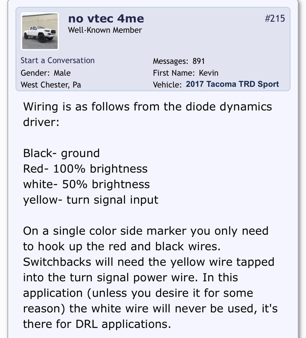

    so, quick disclaimer - i have not wired up a MESO marker light before, and i am just basing this off of info i read in this thread. hopefully @MESO could verify how misguided my conclusions are...
    according to this post:
    i was playing around in the circuitlab editor and came up with the below circuit to accomplish this functionality:
    so, the marker light is wired per the normal instructions, but the white wire will also be connected to the output of the relay. the headlight circuit will drive a relay to override the drl signal when the headlight is on, and if @HIallday 's assumption that the amber will dim after 5sec is correct, i think this might work.
    i think you will need a diode "upstream" on the drl circuit so the voltage doesnt backfeed. also, not sure about the headlight circuit driving the relay - maybe should be inline with headlight power instead of run to ground? anyway, looks like you might only need one relay after all
    idk, just spitballing. roast me if i did something stupid here

    Just to clarify for everyone since ive wired up a ton of these:
    -Amber does dim after being powered for ~5 seconds, so you can run them amber full time without risk of damage (This is an update at some point, some of the earlier strips dont have this feature)
    -They are "low priority drivers", so if white (50%) and red (100%) are both powered, they will default to 50%.
    -I don't see the above mentioned configuration being possible. There's only one wire for amber, so while they are in the dimmed amber position, there will be no way to make them blink 100% amber. You could run them white during the day, and tap the amber wire into the low beam+ so they default to amber when the low beams go on. You would lose the turn signal function of them with this set up though.

    the amber strips have:
    50% amber
    100% amber
    >100% amber for turn signals (assuming these will dim after 5 seconds, but don’t know first hand. Also don’t think it would benefit you in any way)

    Here is the post about the 5 sec dim
    Can anybody confirm this?
  18. Sep 9, 2020 at 7:51 PM
    #458
    MESO
    MESO [OP] Major Modder Vendor
    Feb 16, 2015
    #148809
    16,292
    State of Jefferson
    2016 DCLB TRD HELLCAT SWAP
    Ambers will dim if connected constant. The turn signal is meant to be intermittent so diode runs them at ~150% output. So if you wanted them solid they dim as to not over run the LEDs. Novtech has hooked up a lot so his info is good too
