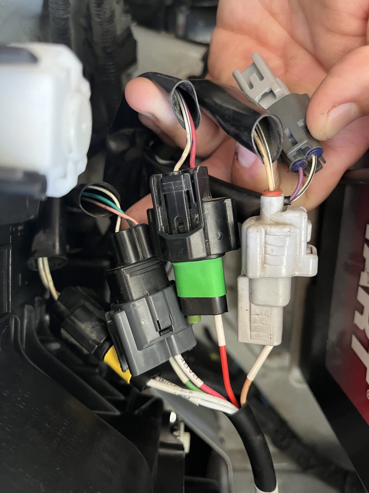

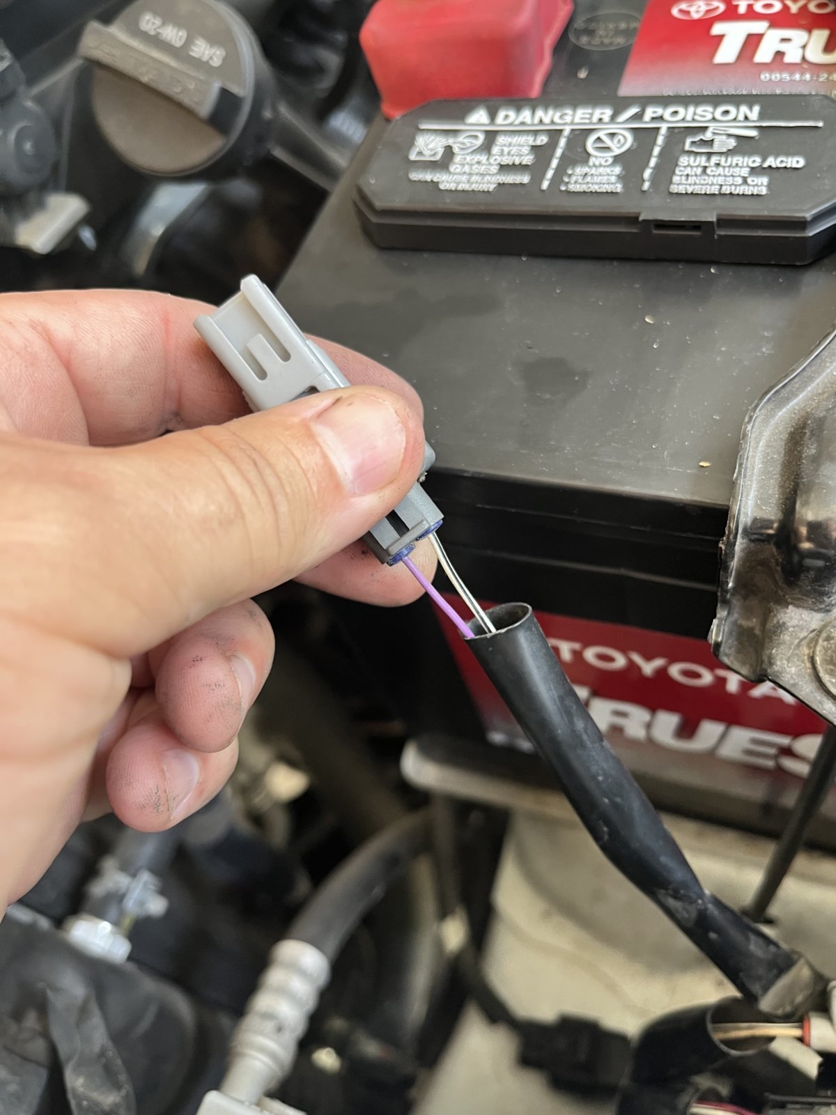

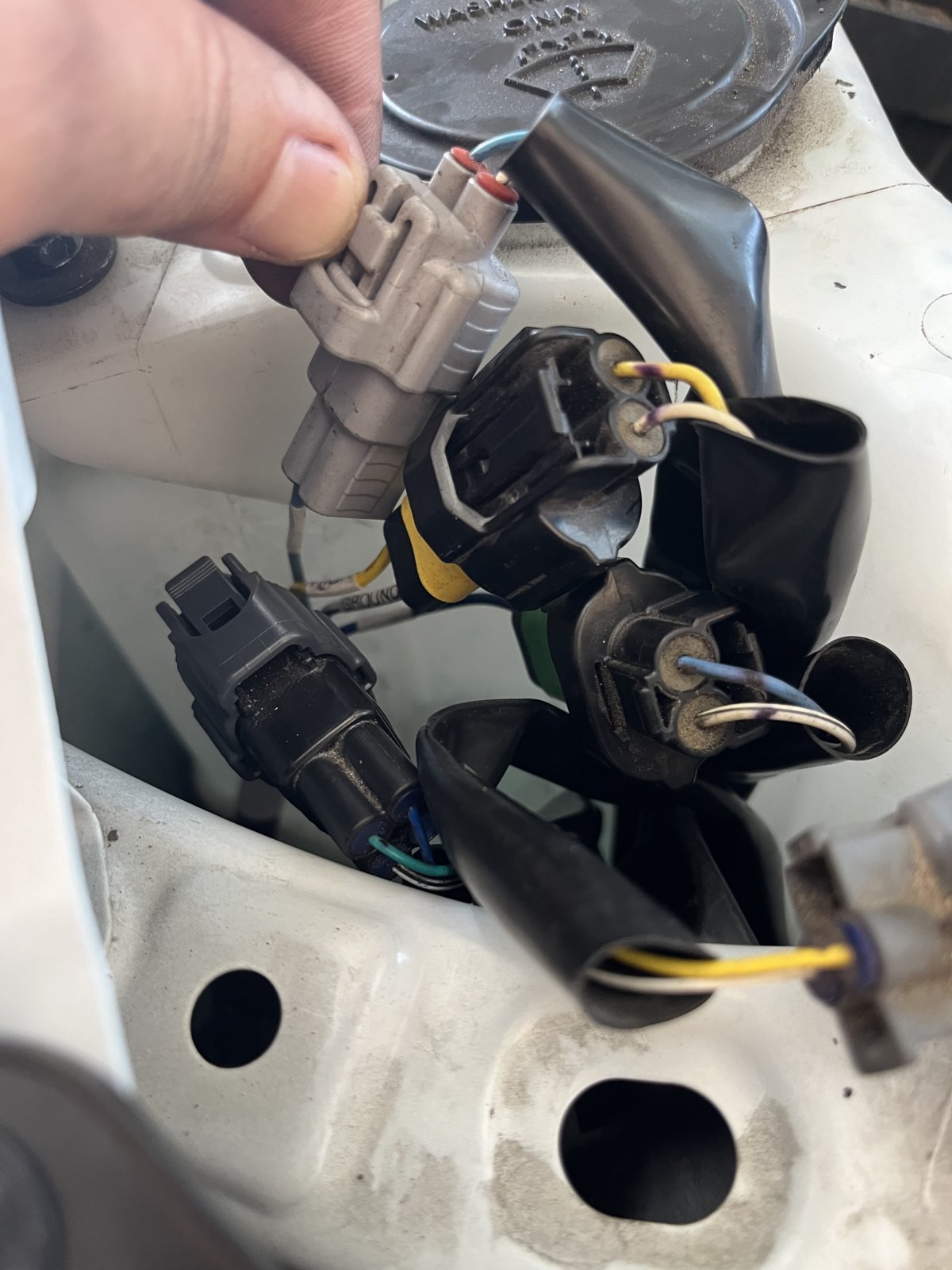

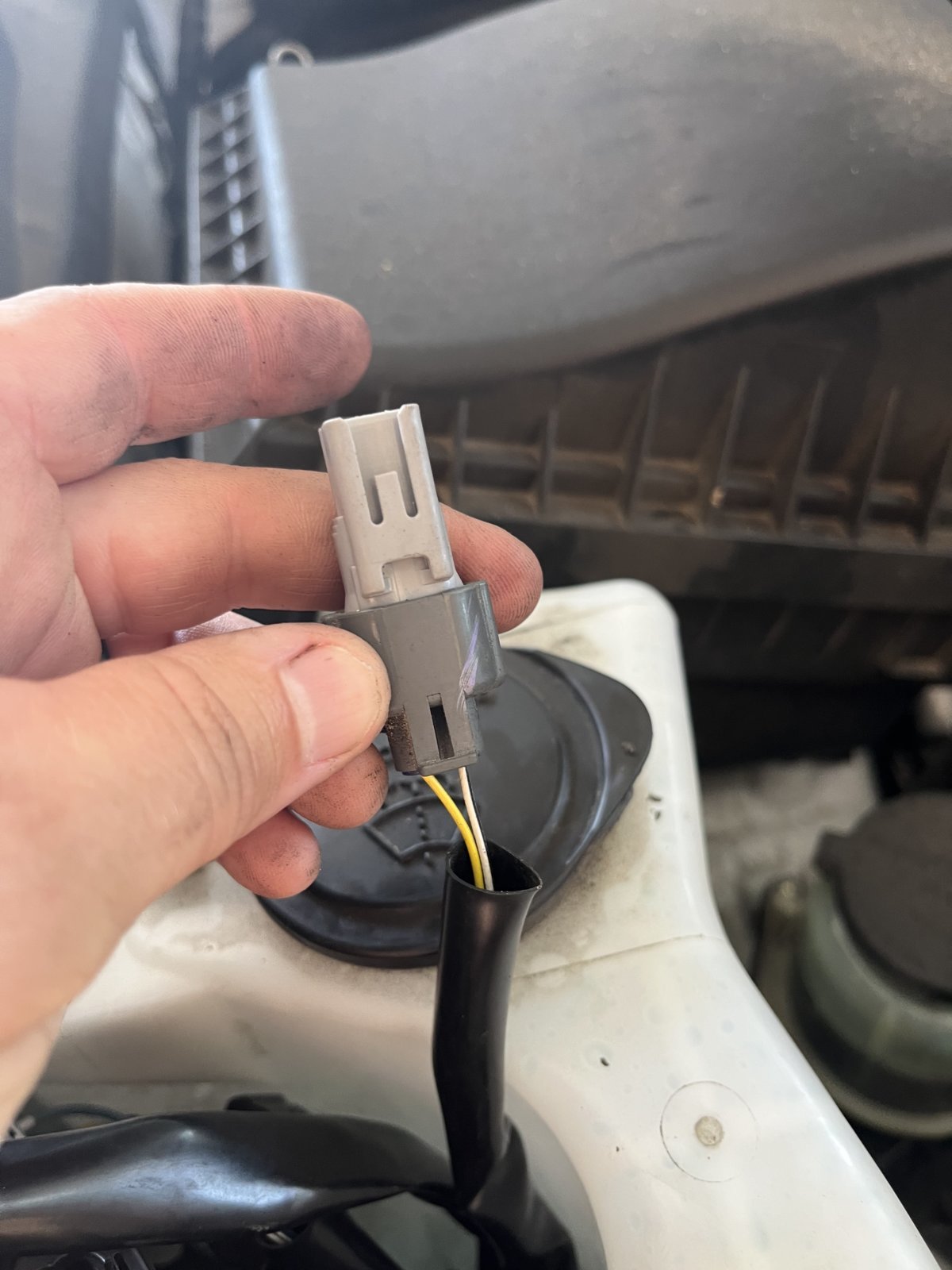

    IMG_4904.jpg Passenger side single wire leftover. Good morning Dave. The turn lights are working as they should at front and rear of truck. I do not see a front parking light working and no license plate light is working. I’m hoping I just connected it wrong. Pics of my wiring on the way. IMG_4902.jpg Passenger side
    IMG_4901.jpgDrivers sideIMG_4903.jpgDrivers side single wire leftover

    If your plate lights are out, blown parking light fuse, it’s 15A inside the can I believe.
    Driver low beam looks good. Passenger high beam definitely good. Driver high beam is hard to see but I think correct polarity. Passenger low beam also hard to see but looks correct as well.
    The sidemarker caps are irrelevant and turn / DRL connectors are impossible to mess up.
    Summary, stalk set to low beams and no plate lights? That definitely points to a blown fuse. Remotely possible there is a short in one of the headlights but that would be crazy rare. If you want to be certain, disconnect the 4 position (3 wires pinned) DRL connector on both headlights, replace the parking light fuse, turn the stalk on, verify rear parking lights, then connect front side 1 and 2 while observing. If one side causes the circuit to blow the fuse, that’s your clue. But I really don’t think that’s likely. Though I also don’t know how you could have blown the parking light fuse in the first place.
