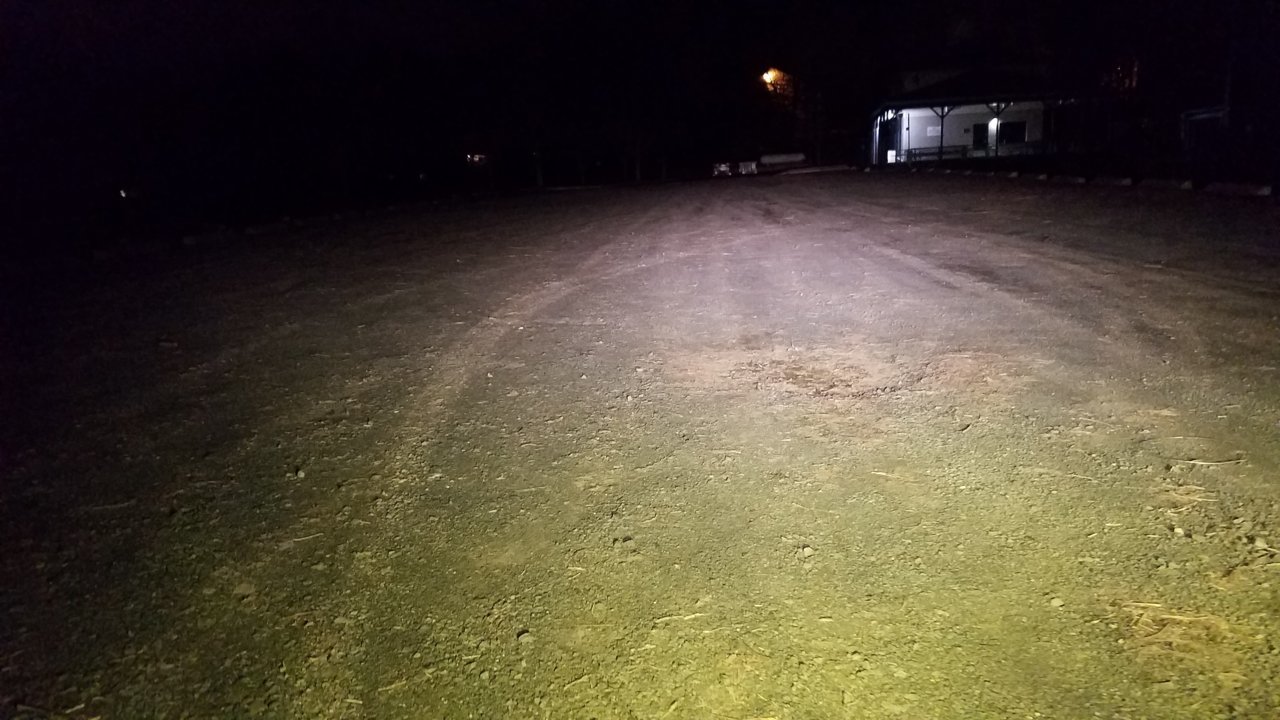

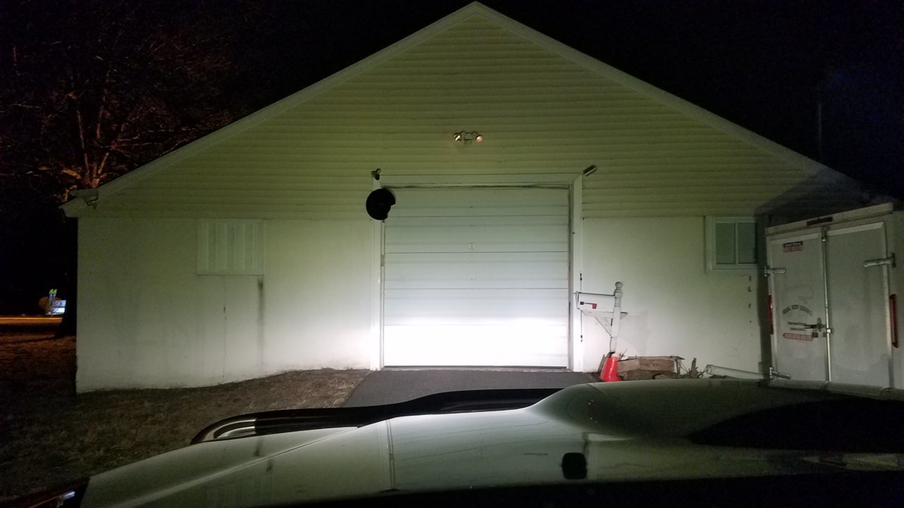

    They are some of the worst ones for having a lack of focused beam. I tried them in my fog lights and returned them the next morning. In the pic, all the yellow wash on the side of the building is from properly focused fog lights with Auxbeam drop-in LED bulbs. As you can see... The light goes everywhere except on the roadway.

    No point in trying to find a drop in fog light bulb that will actually be useful.
    Diode dynamics SS3 sport power fogs vs Auxbeam drop-in LED bulbs
    DD sport SS3 fog lights
