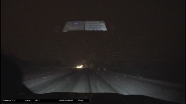

    This is not your typical "What are the best headlights to buy" threads. This is to post about my experience. I like many others, bought the OPT7 Fluxbeam headlights. Where I do love the look of them, I have always been disappointed with the throw of the beam, The spread is nice and the projectors definitely help, however the distance has always been an issue.
    Well today happened. We are in a "Blizzard Warning" which isn't a huge deal around here, sure things close, but I have 4-wheel drive and am not new to driving in these conditions. What was different this time, is it's my first heavy wet snow with this pickup.
    The issue is, the LED's do not get hot so they do not melt the snow on the headlights, this caused the snow to just stick to the headlights, I couldnt see anything light wise beyond 20 feet in front of me (mind you visibility I could still see the closest vehicle 500 yards ahead of me) But knowing I was on the road was difficult. I am lucky that the road is straight, I live and work on the outskirts of town (5 min drive to the office), but still, it was bad. The photo from my dashcam doesn't do it justice, it was much worse.
    I will be looking for different headlight bulbs. Where I love the look of these, safe they are not.

    The headlights won't get warm enough to really get heavy wet snow off. And that's the snow that will stick to your headlights.
    I just drove this morning in heavy wet snow and it stuck to everything. Lights were on for an hour and they were still covered in snow that would not melt or fall off.

    I actually do this usually, but havn't this year.
    My past vehicles have never had issues, each snow this year the snow sticks. I understand what was said above, that they will never be "HOT" to the touch, but there is 0 temperature released from the LED's so there is nothing to release the built up snow even when sitting at stop lights. Anything will be better. So I guess this goes back to the issues of the LED throw in the non-LED projectors made worse by poor conditions, and covered in snow. Either way, the combination was not safe, and is being remedied
