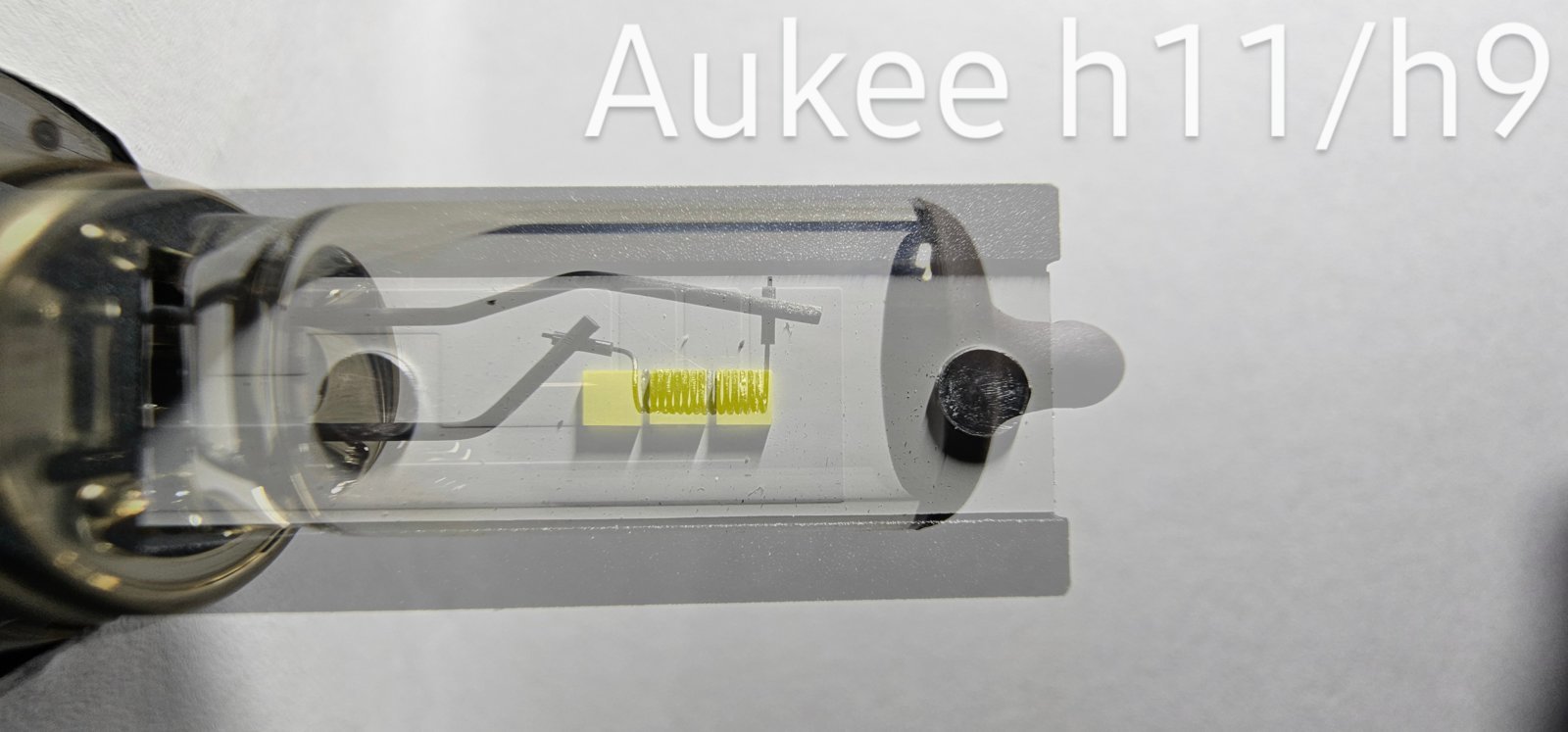

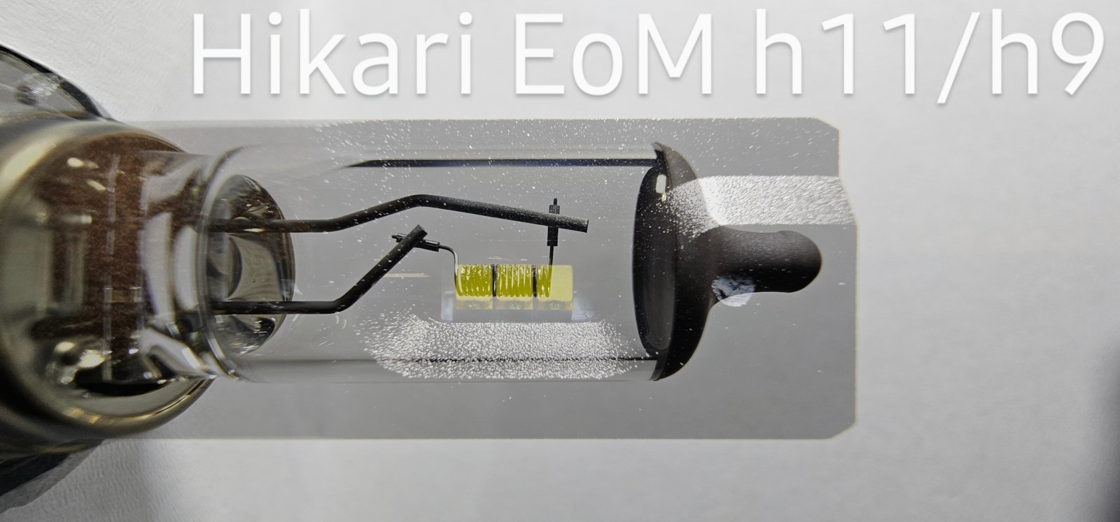

    Some bulbs are better then others. That said it's impossible to tell from pictures what is happening. You really need to get in and do intensity measurements at various points in the beam, and also do intensity measurements at various distances as the very size of the led impacts projection distance significantly. For distance projection intensity per mm squared is what really matters and small emitters with less power can throw light further than big emitters with higher power. I have seen little emitters with just a few hundred lumens far far out throw big emitters with lumen measurements in the thousands.
    This comparison here shows a middle of the road led compared to an h9. This led won't throw light as far as the h9.
    This is the Hikari Ultra (one of Crash's better bulbs) compared to the same h9. This will throw better than the previous bulb and depending on output may or may not exceed the h9. Both however have similar beam patterns
