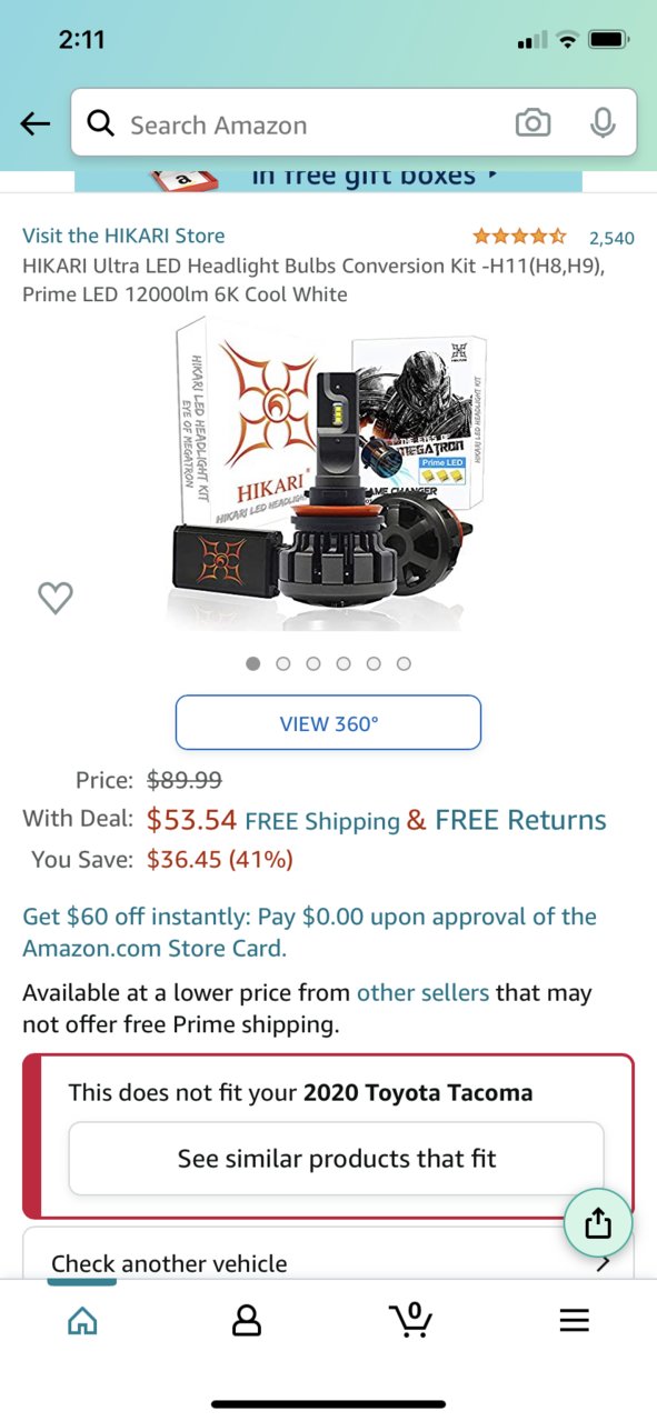

    Michael
    2020 TRD Sport 4x4
    Does anyone know if these will fit my
    2020 tacoma? I trust the opinions more on here versus Amazon haha! Also, will the “cool white” color match my daytime running light color?
    thanks fellas!

  5. Nov 17, 2020 at 6:09 PM
    #65
    tclavell
    Aug 7, 2020
    #336897
    12,481
    Troy
    Phoenix, AZ
    G70
    Yes, they fit fine. I have a 2020 and ran them for a bit before going back to halogen. They are currently the only recommended LED by our resident lighting expert, @crashnburn80
