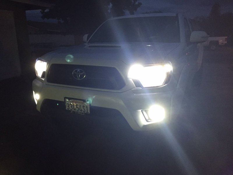

    Tried to take a picture of my pattern last night. Failed. But here's a good day picture. In the center you can see there is a dark spot on the fence. There's no light on it. Its roughly 3 feet away. I'll take a picture of the ballast deal later uploadfromtaptalk1444143118558.jpguploadfromtaptalk1444143134487.jpg

    That is horrible. Is that on high beam? You cannot even make out the cut off line which should be super crisp. The beam pattern is all over the place and would blind everyone and waste light by not putting it on the road.

    Yea. They're I'm not sure if I somehow messed up the install or something

    Well maybe I have the bulbs turned the wrong way... uploadfromtaptalk1444163356541.jpg

    The H4 positioning tabs should make it so that is not possible. You shouldn't be able to mount them incorrectly.

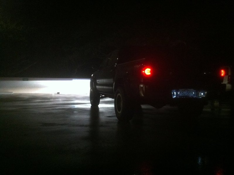

    See how in the 2nd pic that it doesn't flood the entire housing which would scatter light everywhere
