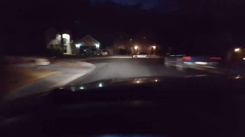

    @I'mTheDude Here you go bud. Side by side comparison with stock Osram. I took 2 photos.
    I"m actually quite surprised how well the stock Osram (right/passenger) is almost as bright as the Sylvania (left/driver). You can barely tell the whiter color on the left side, so it isn't as shocking of a change as in my wife's RDX. Perhaps in the RDX it was 3 year old halogens that mattered.
    I guess I may just end up doing HID after all. I'll give these some time to see how they do.
    I'mTheDude likes this.

    I'd like to follow up on my post here, as a matter of fact when i was driving on a road with lots of reflector signs and barricades from construction, these headlights were amazing! The squirrel spotters shined an HID-ish hue of white far away that lit up the reflectors, while the beam ahead of you is still a little bit more "warm color" hue. I'm very happy with the performance of these bulbs.
