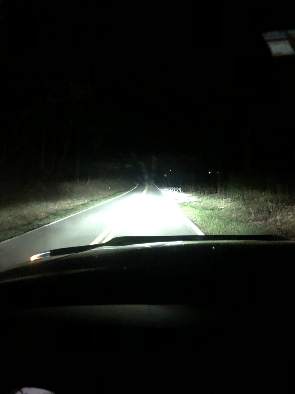

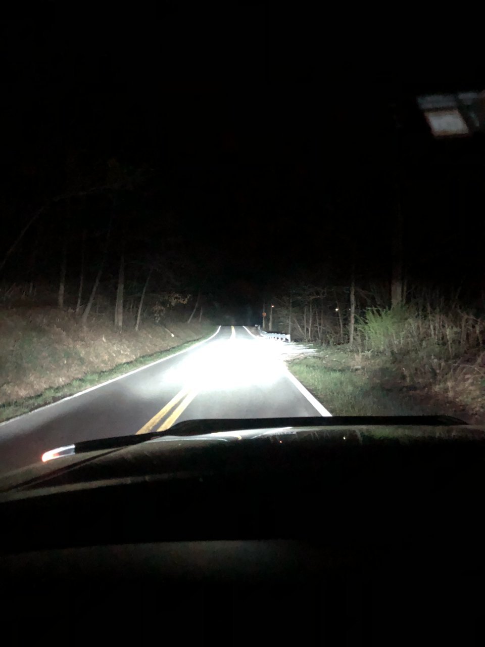

    6766D90F-AF7E-4F94-911A-AAD84DF26BDB.jpg BB740735-34EF-4485-B9C8-F92952F028EE.jpg Just installed the Hikari Eye Of Megatron led replacement headlights , I must say I’m impressed , living in southern WV there are some dark roads here , and they light up the road low beams high beams there both great , this is in a standard housing on a 2015 Tacoma,,,,,, anyone else have these ? And what’s your experiences with them ?

    You asked for opinions, so I'll offer mine. That's a terrible looking beam pattern. One huge hot spot and lots of scatter around it. Further proof of why LED replacements should not be run in housings designed for halogen bulbs. I'll pass thank you.

    Well still have adjustment to make , and so far it’s not bad for oncoming traffic

    Unfortunately you are wrong and it has been proven a million times over that LED's do not belong in Halogen Housings. But hey as long as you like

    Welcome. The name of those bulbs sounds soooo Japanese. Lots of people on this forum will give you crap for running HID or LED bulbs in the stock housing. I have lower expectations. Around me people don’t run any lights, one is burned out, or the high beam is on because one is burned out. Lol. But if you walk out 25 feet from parked truck on level ground and the headlight isn’t shining in your eyes I would say you are fine. Countless lifted vehicles are just as bright with their headlights adjusted poorly as yours will be.

    Performance is aweful, and there is significant hazardous glare. Your output photos show a massive blob of light right in front of the truck, no distance projection and non uniform light distribution, which is pretty typical of drop in LEDs.
    Compare your LED lights

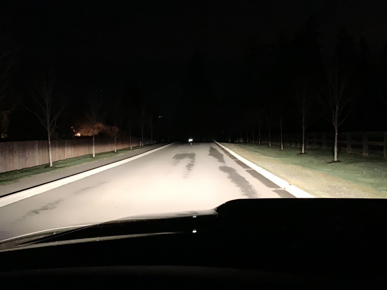

    To a halogen upgrade:
    While photos are not a great method for comparing lights, you’ll notice that the light distribution and saturation is far better, they project further, and don’t cause excessive glare. Take a look at that thread linked above.
    And even if you did a projector retrofit, LEDs do not project well compared to using the halogens, because that is the light source the housing is designed for.
