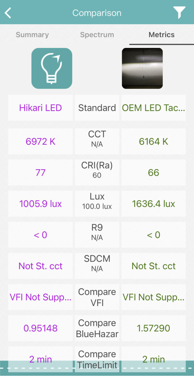

    PnP Hikari vs OEM LED. Like I said, not even close.
    The Hikari has crap blue color temp at near 7000k. The Hikaris numbers are actually inflated in this measurement because the 18' distance is inadequate for a pnp LED to integrate in a halogen housing, meaning the OEM LEDs will actually be substantially better than shown here by comparison. The OEM LED is significantly higher output intensity, wider beam pattern, better hot spot, better uplight and superior in every single measurable metric. The Hikaris are Chinese toys, while the OEM Toyota assemblies are some of the best lighting assemblies on the market.

    I never said that Hikari are better than OEM LEDs. Based on my observation Hikari were night and day compared to OEM halogens but not that much different than OEM LEDs. I mean yes, OEM LEDs are better lights no questions, just not "Wow what a difference!" better over Hikari. Again, just my real life observations.

    Are the Hikari Ultras? I ran those for almost four years, and I they were decent. I have since swapped to the OEM LEDs though, but don’t have any frame of reference except the fence at the end of my driveway. That is why I am asking, the color temp doesn’t seem that far off? Maybe the yellow of the cedar fence isn’t the best test though :rofl:I can’t wait to be able to drive again (shoulder surgery recovery is taking way longer than I thought) to see how the LEDs do on the road. Even if they didn’t perform way better, they look cool on the truck :thumbsup:
