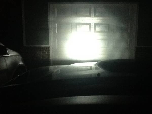

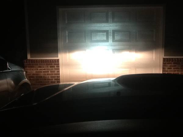

    Not nearly as good as the video, but might help for comparison between the rigid driving (video) and the flood/spot combo (below). Obviously it's my garage door, so doesn't help with distance. My advice is that if you are only going to have the scoop light, go with the driving for the extra money. I'm happy with my flood spot combo because I have a 20" behind my lower grill that provides a wider beam. If you look at the spec sheets on rigids website, you will see the driving spreads 60m each side and the flood/spot spreads 30m.
    With low beams
