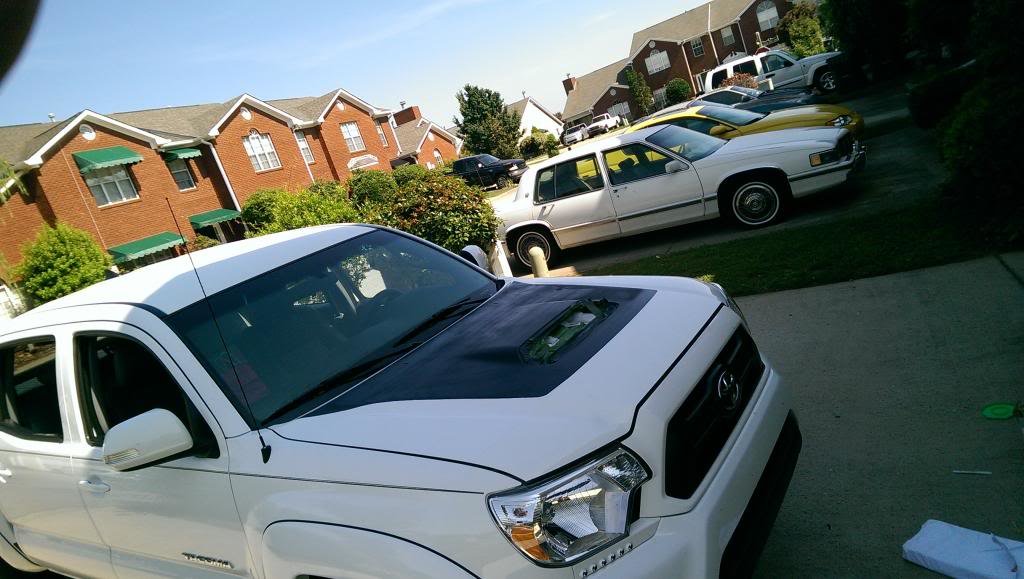

    In the process now. To take scoop out there are 4 10mm nuts and 3 plastic plugs. The middle one is easy to remove w needle nose pliers. With the outer 2 it was a little harder but I managed with 45degree long needle nose just because of the hood's structural brackets hiding the plastic clips. All told 10min to remove.
    Also tried the plasti-dip thing in the hood to kill the glare off the white hood and scoop. not bad for $15 and can be peeled off whenever.

    Plastidip on the scoop is a good idea. The only thing I don't like about my truck is when the sun is at just the right angle, I'm blinded by the glare off the scoop. I need a sun visor on the dashboard too! :eek:
    I see you have those DTRL LEDS below the headlights. What do you think about those? Personally, I do not care for them. I assume you are trying to make the hood scoop match?
